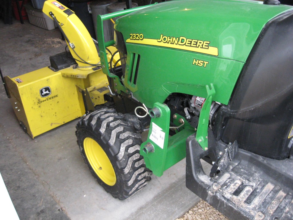

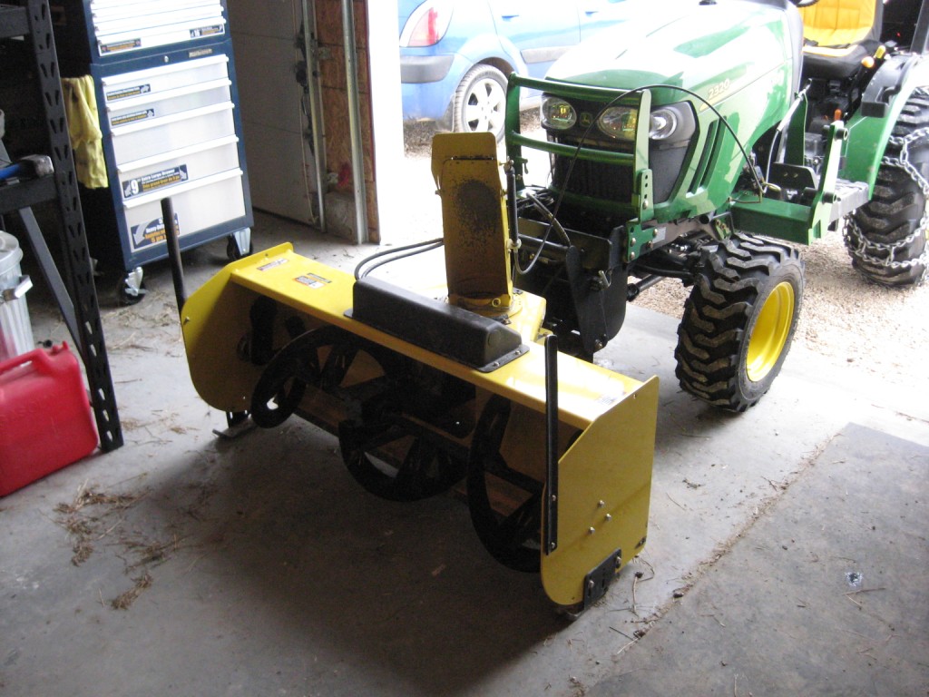

JD 54" QH Snowblower

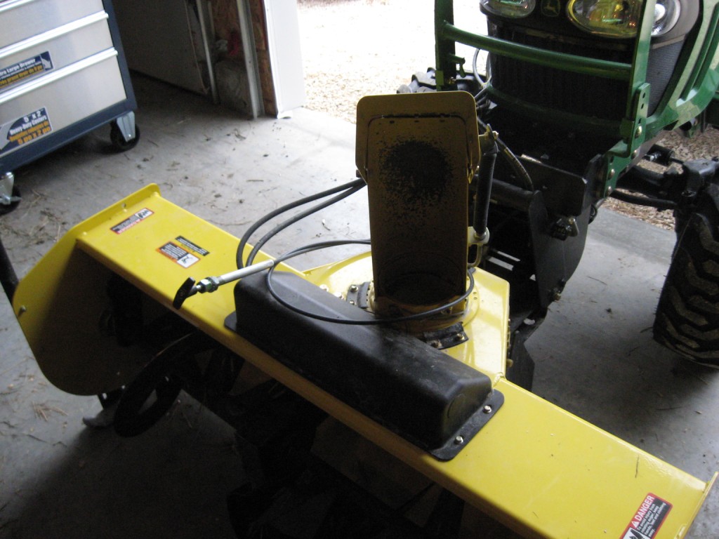

01 - 54" QH snowblower
02 - spout cable

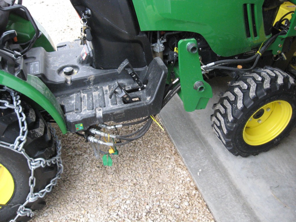

03 - hydraulics

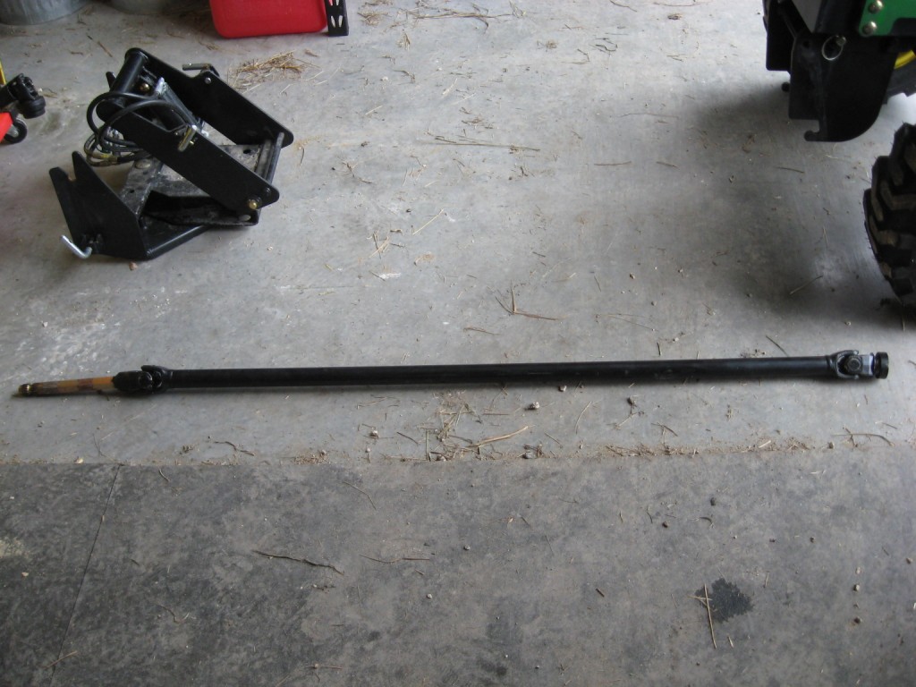

04 - snowblower drive shaft
Snowblower removal

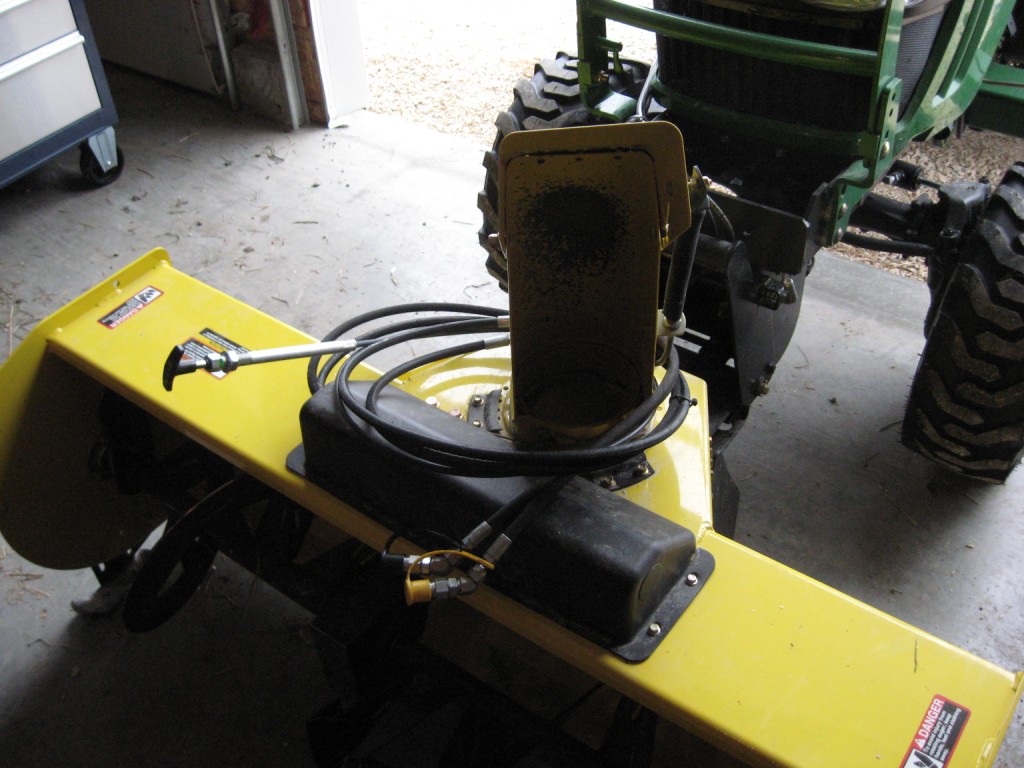

05 - remove spout cable
06 - coil spout cable around chute
07 - disconnect chute rotation hydraulics and coil around chute
08 - leave QH hydraulics connected
09 - disconnect snowblower driveshaft and place on support rod

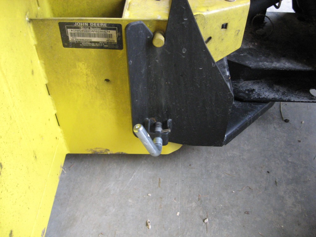

10 - unlock front hitch levers

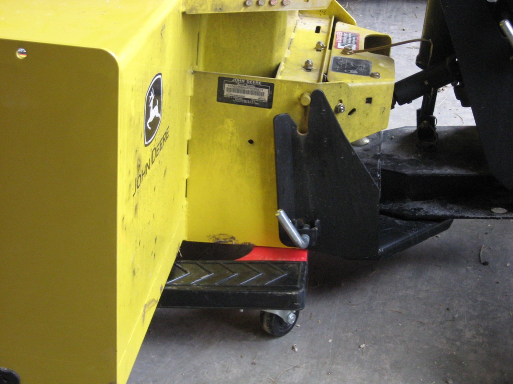

11 - use a dolly for easy snowblower storage moving

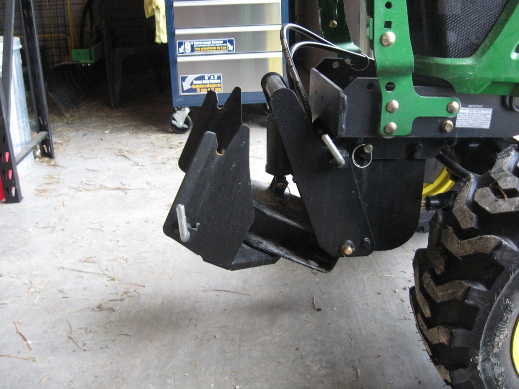

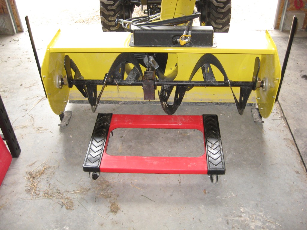

Quick Hitch Removal
12 - lift QH and slide dolly under snowblower
13 - lower QH and back away. Use dolly to move snowblower.
14 - raise QH
15 - disconnect QH hydraulics and coil for storage, unlock levers, lift and remove QH

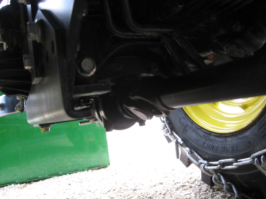

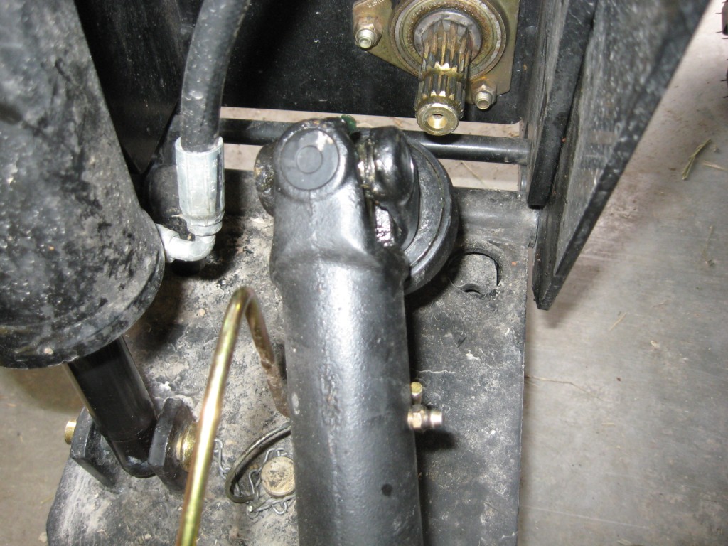

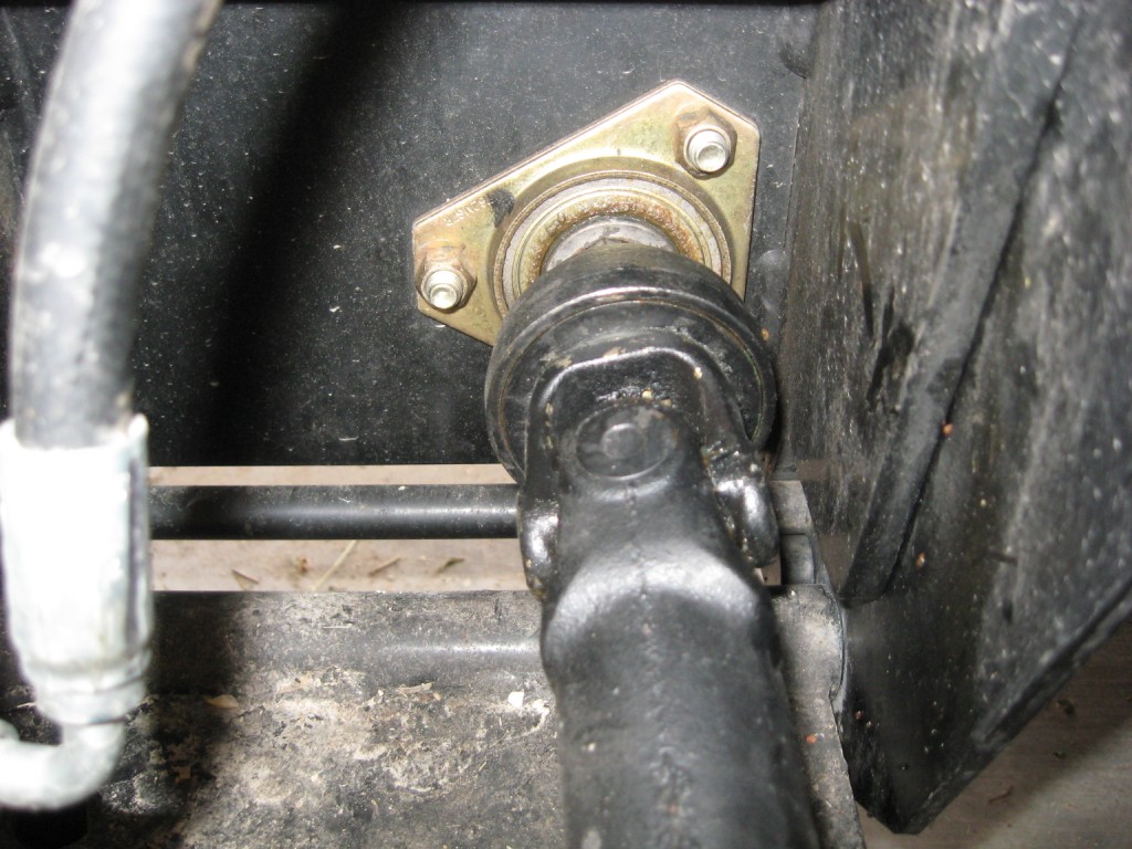

Front PTO driveshaft and front hitch removal
16 - disconnect front PTO driveshaft at mid pto. Pull back on colar to release. Move forward to clear mid pto.
17 - move driveshaft rearward to pull out of front pto bearings

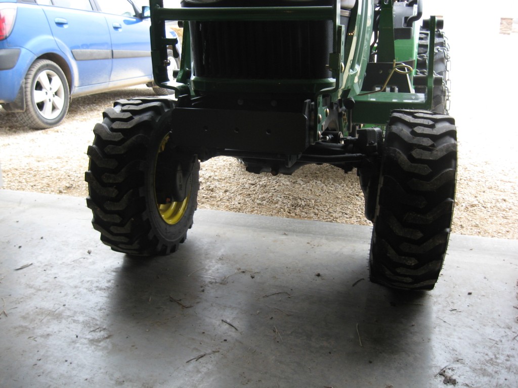

Front PTO hitch removal
18 - to remove front pto hitch
19 - pull out retainer rod and lift out hitch assembly

/ JD 54" QH snowblower removal #2
Dmay thanks for that post nice job. I couldn't resist copying all the photos for future reference.
