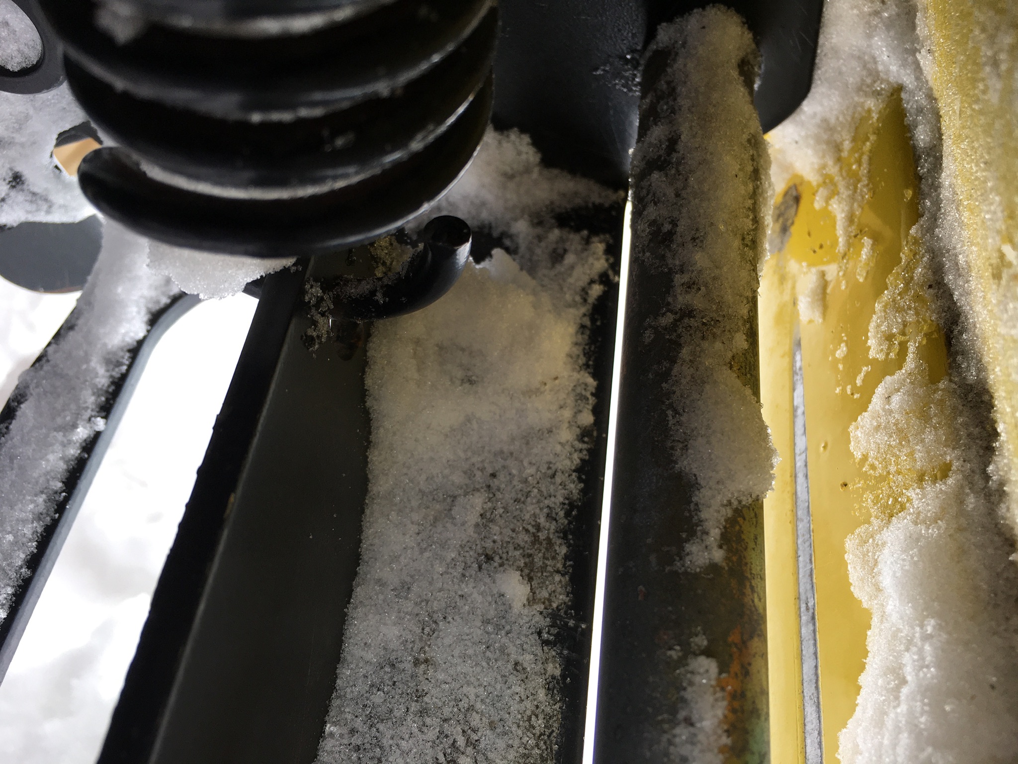

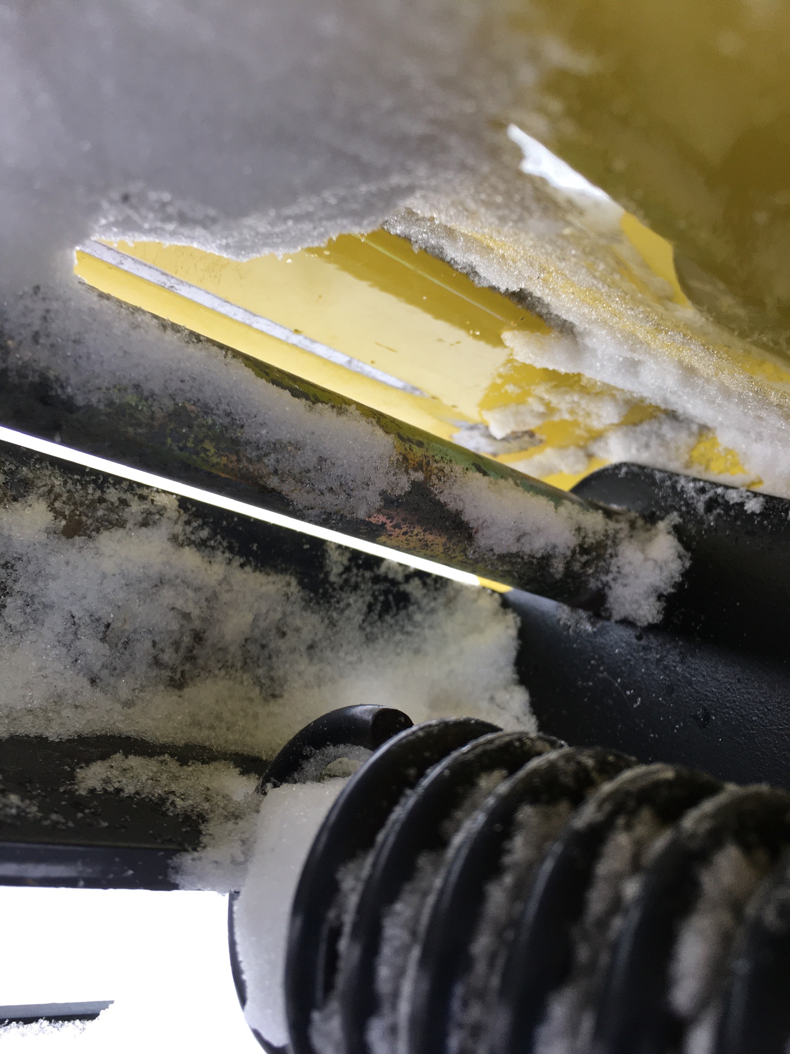

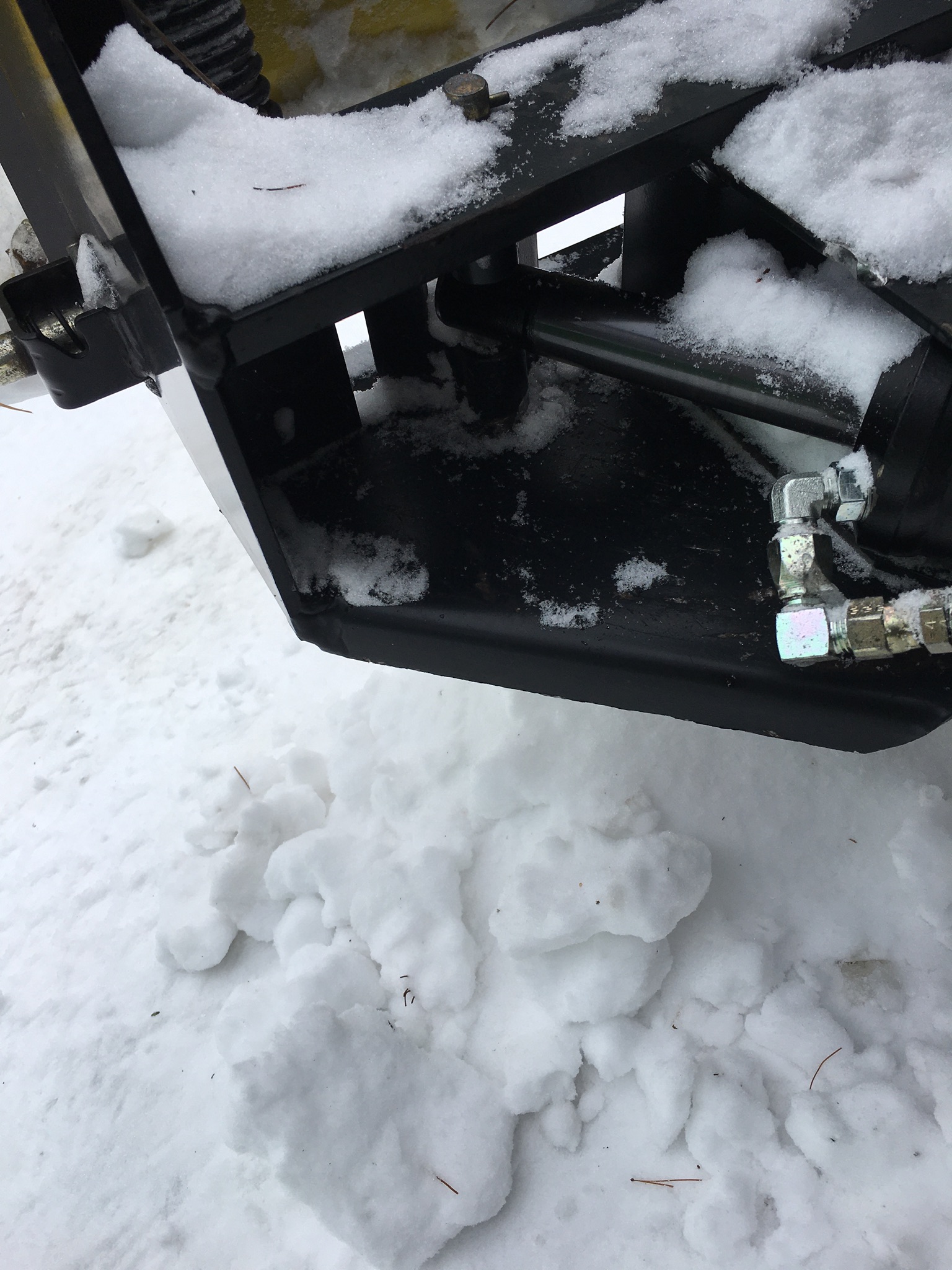

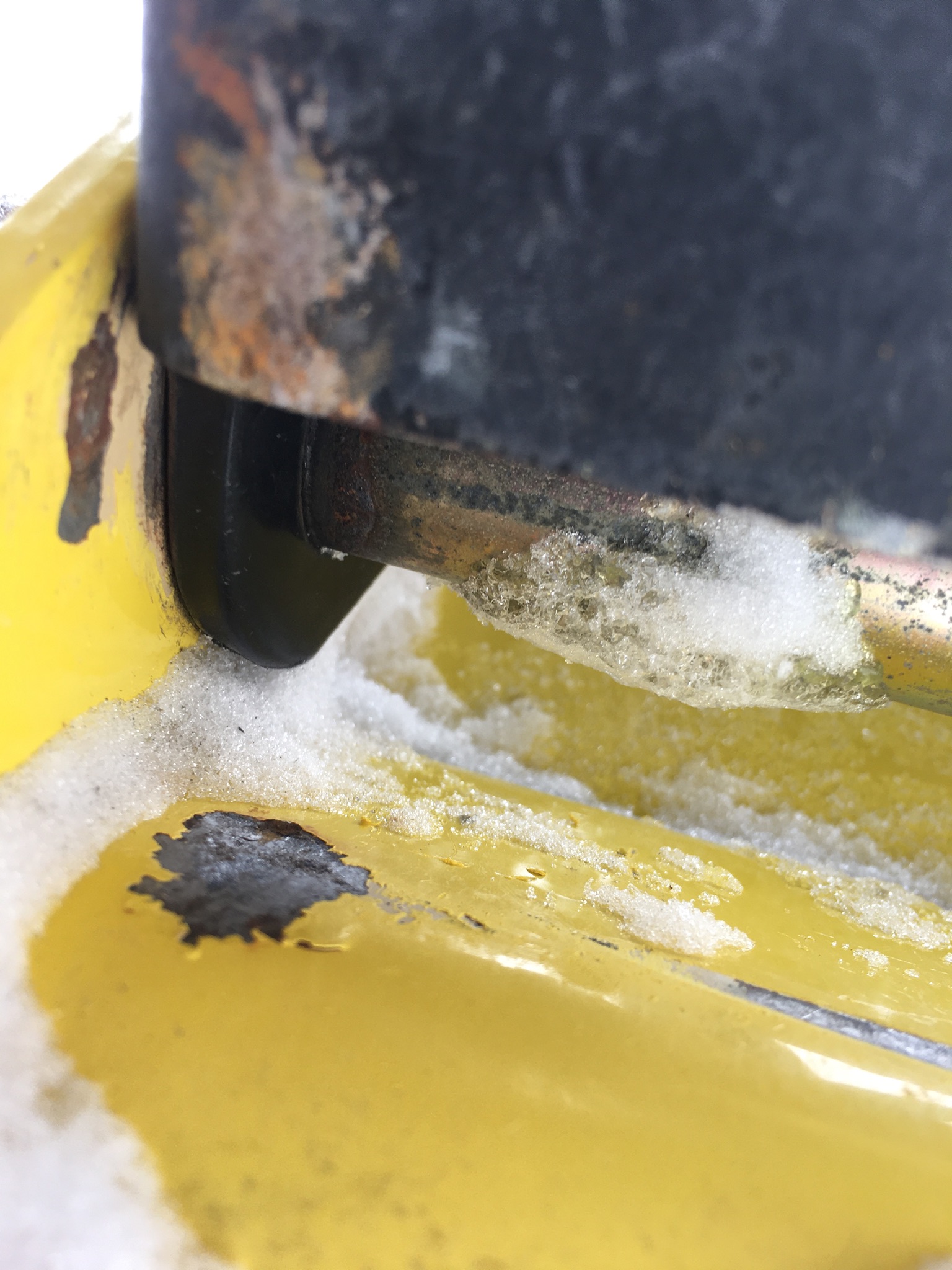

BCB8564F-6971-4BD2-AFC6-DAA89FAD8CAC.jpeg108F23F6-6A5F-4291-BB33-0DE7203F1747.jpegA74A5E27-600D-47E3-B538-4C4600228EE1.jpeg9977F5B7-4ABE-442E-AE3C-957EB0D739E6.jpegBCB8564F-6971-4BD2-AFC6-DAA89FAD8CAC.jpeg108F23F6-6A5F-4291-BB33-0DE7203F1747.jpegA74A5E27-600D-47E3-B538-4C4600228EE1.jpeg9977F5B7-4ABE-442E-AE3C-957EB0D739E6.jpeg
When I checked, I see that the brace across the bottom of the blade does hit the bracket to limit forward tilt. I hope the first three pictures show that. The last picture shows the hydraulic fittings on the front of the index cylinder. If the temp outside and the hydraulic fluid temp are just right, snow packs in the cavity ahead of the piston and turns to ice and the fitting bends as it gets pushed into the ice and then breaks. You can do lots of plowing without trouble and then it happens. Just something to watch.

Thanks Sno! It’s funny you mentioned that, because I watched a video not long ago and the guy demonstrating his plow had mentioned that and to to also clear the snow out from that area to avoid ice build up. Good to keep in mind while pushing around that white stuff!
