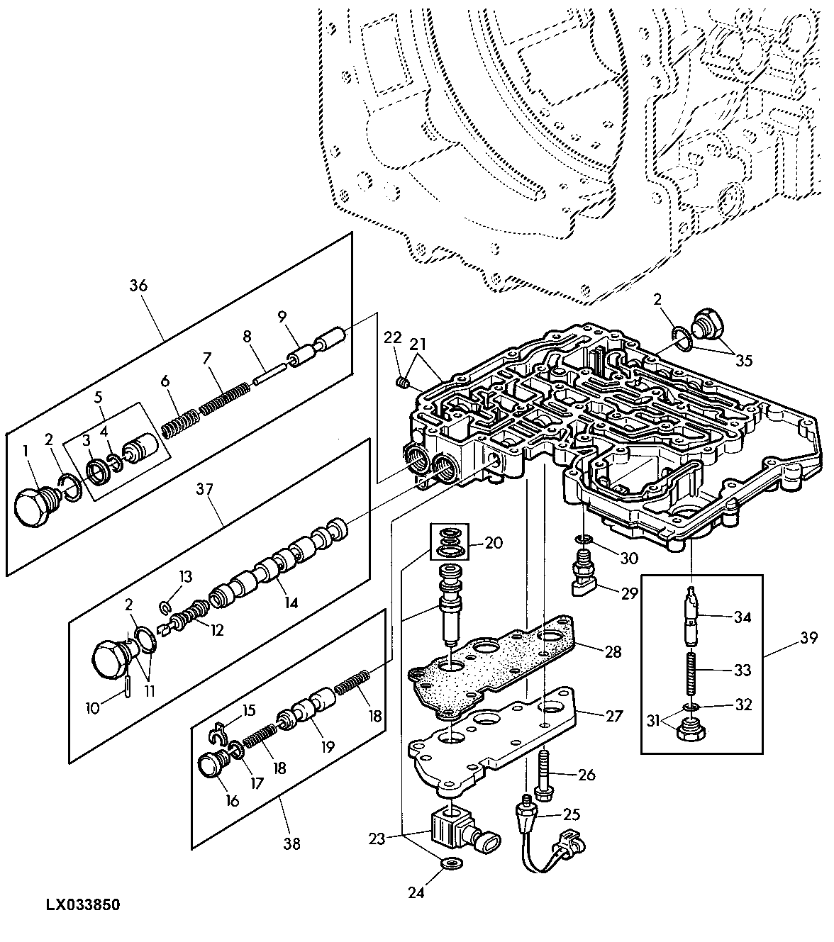

   / JD 6410,238 hrs,power reverser not working #14
Bottom of power quad, key 23 is solinoid

Solinoids: Three under the tractor bottom of PowrQuad. Front to rear: Reverse, has Purple and Black wires harness side of connector. Forward, has Light Blue and Black wires harness side of connector. Enable, has Gray and Black wires Harness side of connector. Disconnect ONE AT A TIME check connection for corrosion. Use an OHM meter to check the solinoid should be about 12 OHMs. Put a test light across the harness side connectors. That is to test Forward, test light will go from Light blue to Black. Shift Reverser lever to Forward and test light should come on. DO NOT BE UNDER TRACTOR!!! Run wires to where you can see the light or have a helper monitor the light from a SAFE place. Enable should power the light if OK in either direction.
If after testing Fuses, Relays, Connections, and Solinoids and still not working, I would change the Enable Pressure Switch, Its by the Reverse Solinoid. I agree park switch probably not the problem.
