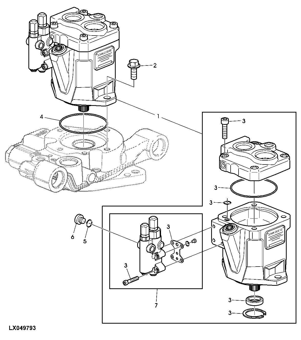

TxJim, The standard and premium do not use the same pump. unless it has the upgrade to PFC system. The standard PC system uses a gear pump where the PFC system uses an axial piston pump - very similar to the pump on a hydrostatic transmission.
jd110
All I know is this pump is common to both the 6430 & 6430 Premium AL166639 HYDRAULIC PUMP (45CM3). How does the performance of the PFC system compared to the older closed-center systems?

TxJim, the PFC systems are definitely superior to the closed center systems of the 10, 20, 30, 40, 50, 55, and 60 series tractors. They offer more flow, higher pressures, less parasitic loads, and therefore better fuel economy numbers can be achieved. SInce they are pressure and flow compensated, there are less variation in flow from one scv to another when using functions that require steady flow such as the vacuum motors on modern planters. The only downfall is that they are more complex, so there is more chances of things to go wrong, although they have been very reliable. One of the best improvements is they no longer use the transmission pump as a charge pump for the hydraulics. They now have a separate charge pump that offers even more flow than the main pump. As you remember I am sure, the older systems relied on all return oil from functions to be returned to the main pump for proper operation. The charge pumpp with maybe 10gpm was trying to supply the main pump which was capable of maybe20gpm or more. Gone are the days where a leak in a pto clutch or transmission pack will affect hydraulic functions.
