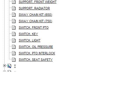

I have a 1984 JD 650 the battery is good and I can not get it started. How do i tell if it is a bad safety switch. I have had this problem on & off for the last two years. It will not even turn over. It frustrating

Yes I had the battery checked at walmart. they said it was putting out 700 Amps. I cleaned the cables & battery post good. Last year I had a guy work on it and he cleaned one of the wires on the starter, (not the one leading to the battery). It started right up, except when he went to drop it off it did the same thing. He disconnected it and re connected it and it started. I checked that and it looks good. When i turn the key the only thing that happens is the lights on the dash light up and I hear a click under the dash. I tried jumping it with my van and put another battery in from my truck. Last summer once in a while I could not get it started. sometimes jumping it with my truck. I read in an earler post something about a safety switch under the dash ? Can some one discribe what it looks like? Im only guessing that is what is wrong. 3 years ago the PTO saftey switch was replaced. I do not think it would be that yet. How do I tell? Thanks for your help

There are not many switches, and here is a list of them from jdparts. You can look them up too on jdparts.com to see where they are located. Somewhat self explanatory, but if working intermittent, could be a problem for you.
