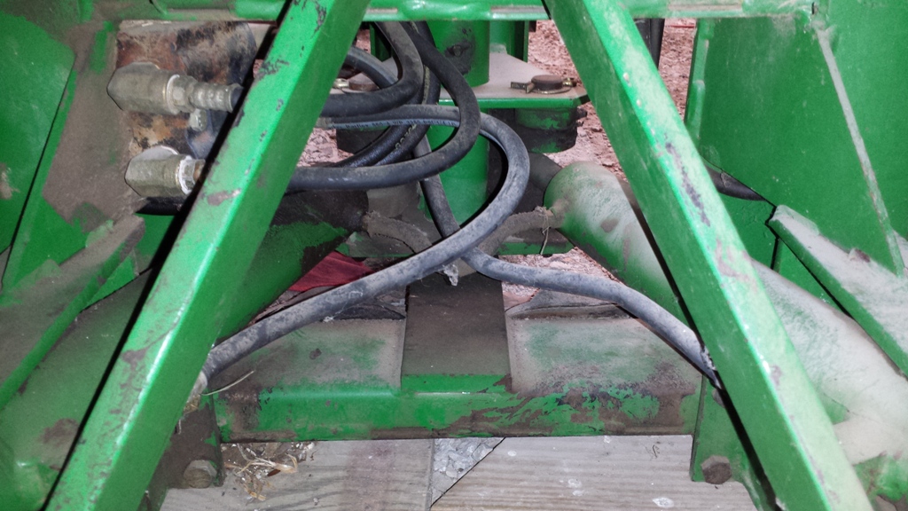

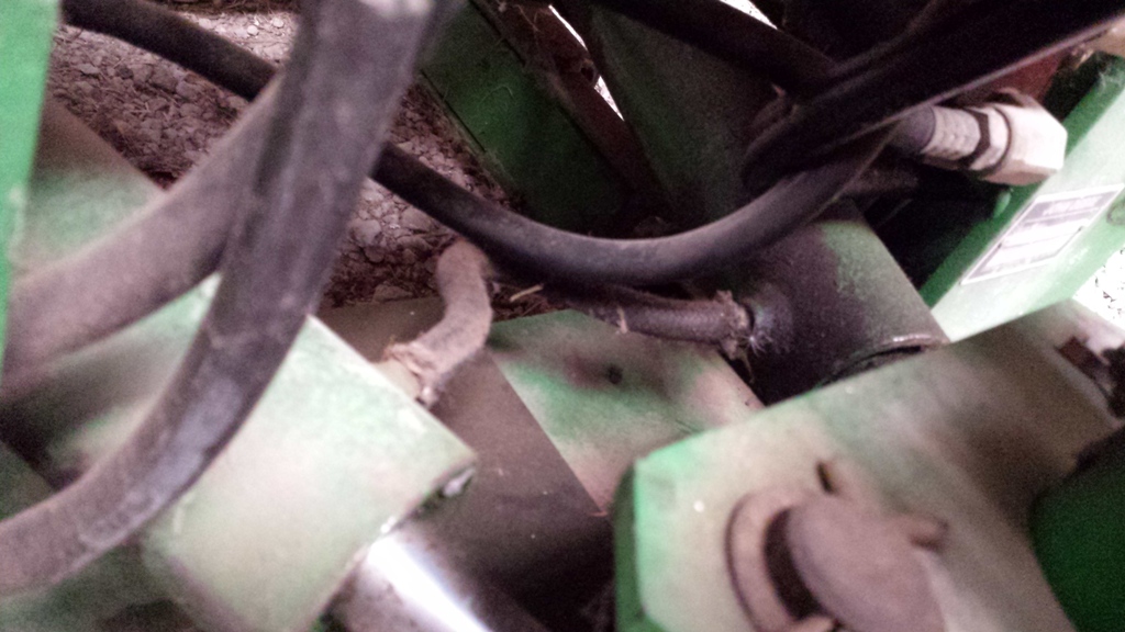

   / JD #7 Backhoe - swing cylinder rebuilding - how to dismantle? #12
The swing circuit on the #7 is comprised of two single acting cylinders controlled by a double acting valve. This design gives the boom swing equal power and speed and in both directions. As mentioned above, the hole in the gland is a vent for the non-pressurized side of the single acting cylinder. There should never be anything but air on that side of the piston. Since you have hydrualic oil pouring out that vent, it means that your piston seals are shot. The bad thing about the design you have is that there is nothing to keep dirt, water and other crud from getting into the cylinder and once it's in, there is no way to get it out. The dirt and crud wreaks havoc on the piston seals when the cylinder is cylced and can also lead to scoring of the cylinder walls.
The other style of cylinder that has no hole in the gland, extra port, and short jumper hose from cylinder to cylinder allows the compressing air to vent into the other cylinder's expanding air space making it a closed system which keeps the dirt and crud out of the cylinders. It's a much better design.
Thanks for the clarification and that makes sense. That mixture of crud you describe is what coated me when I tried to loosen / remove the plate by pulling on the rod unsuccessfully today. Quite a nice mixture of dark gray / black ooze it was. Left penetrant sitting on the plate tonight hoping it might help loosen it if it is indeed only stuck on there as suggested earlier.
Unless someone tells me that plate is screwed in or otherwise retained, I am thinking about using a strap with a ratchet on it and slowly pulling the rod with that and see if it works out that way.

I think you will find it is not a "plate" but about an inch long bushing-like guide. Parts calls it out as a guide.
And I agree with mechanos, to not use a strap.
Maybe consider adding a port to the cylinders to connect a hose as shown in the pic. Might as well add new seals to both as the other one likely is in need, or soon will be in need of new seals.
