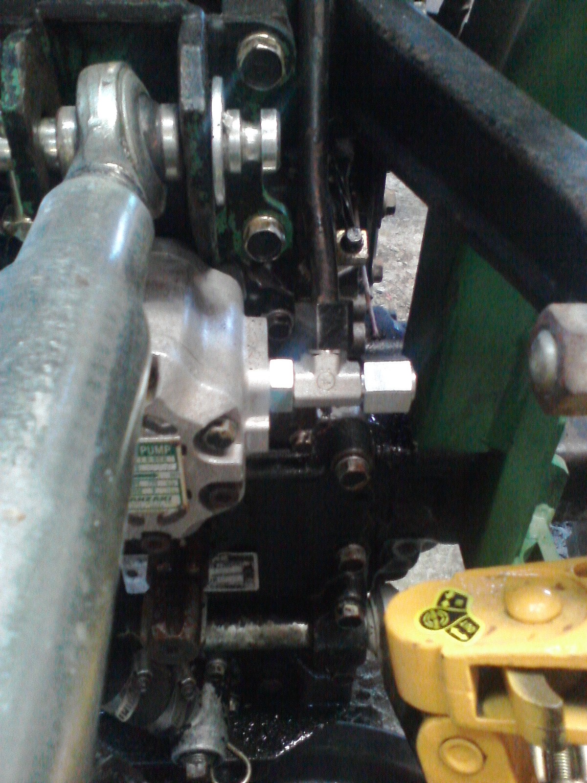

The pump is the correct pump my tractor. Rated at 7.2 GPM. Flow is divided between the hydraulics and power steering. 70%/30%... so that's 5 GPM through the hydraulics.
Here is the hydraulic schematic... mine is the 955.
View attachment Hyd schematic.pdf
Back to the fitting again if everything else is good. Did you eyeball each fitting in the lift circuit. Some people want a slow loader when they first use a loader, and forget later on, that the restrictors are still in the circuit. QD's will slow the flow a little. Are the QD's allowing the full flow to the cyl? If your pump flow is 5 GPM, do you think you can fill a 5 gal bucket in one minute? Try this with the hose removed off the cyl port. Keep in mind that the GPM's is flowing to two cyl in normal operation.
If the pump is putting out a certain GPM, and you know the cyl dimensions, then the speed of the cyl operation can be computed. The mechanical hook up may degrade your times.
My tractor's reservoir is about 4.5 gallons, so I'd have to time the discharge of a smaller volume of oil and extrapolate from there.
Here's how I tapped into the system for a pressure gauge. I removed a 90° fitting at the pump and replaced it with a capped Tee. I removed the cap and attached my pressure gauge to the Tee.
Here are the results:
Rockshaft relief: 2750 psi
Bucket curl relief: 2750 psi
Bucket dump relief: 2750 psi
Boom lower relief: 2750 psi
Boom raise relief: ~2550 psi average... very irrattic readings... needle bouncing all over the place.​
Based on the readings, it looks like I have bad piston seals in the boom cylinders as suggested by others. I did not try to identify which cylinder as I'd replace the seals in both to keep them matched.
