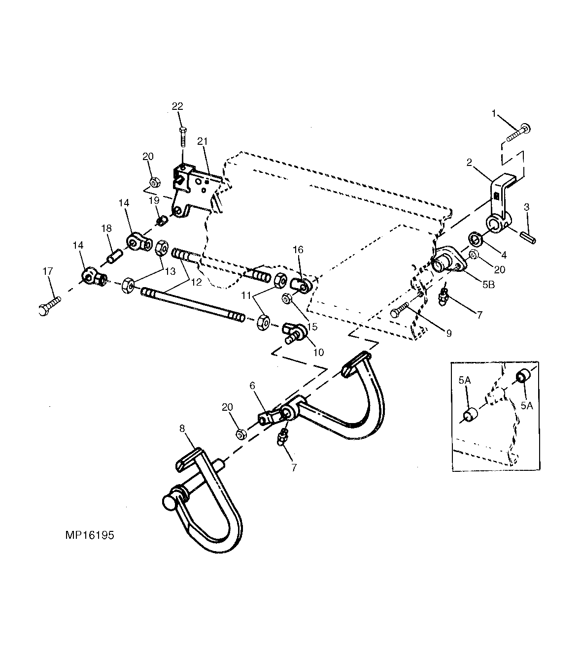

I am still trying to adjust for the creep, their is a small cap nut you loosen and then put a wrench on the eccentric to adjust. The problem in have is the space between forward and reverse is very small and when I think I have it adjust and take it for a test it still will either creep forward or reverse depending on how I tried to get it just right. When I adjusted the tractor on the jack stands it looks good but when it on the ground it is a different story!! Help
   / JD 755 slow creep forward #12
Then I would suspect sticking control rods, etc. Maybe time for a pressure cleaning, and some light oiling?
   / JD 755 slow creep forward #13
Usually when I can't get one adjusted, it is because the bolt holding the cam on the hydro has come loose. It allows enough slop in the adjustment that it creeps either forward or reverse. Bolt #22 goes through cam#21. tighten this bolt and see if that helps.
