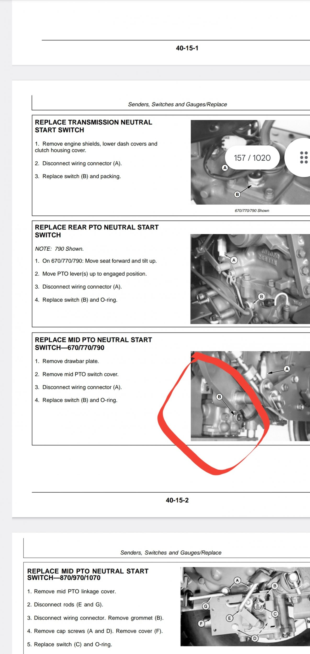

Next dilemma, I don't think I have a mid pto, there is no box with a switch. So the jumped cables I assume are for mid pto. Back to bypassing seat. Can I wire nut the wires?

I do not have anything that resembles this.

Thanks for all the responses. We did get it moving. It was the seat safety switch. I did wire nut the the two reds together and black and white together to bypass and we are rolling!!! I am so happy I didn't have to buy another part.
