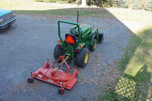

Hi, I own a 670 but I did do some research (after the purchase!!).
(I'm assuming the 770 you're looking at is a 4WD model)
The 770 has 20 HP at the PTO.
It weighs ~2150 lbs (from the JD 670/770 Operators Manual). This weight doesn't include the FEL.
It uses a 3 cylnder Yanmar diesel engine, ~84 c.i.
Power steering is optional, so you'll have to check this yourself.
OAL w/ 3PH is 111.2"
Height with ROPS is 79"
Width with turf tires is 53.8"
Ground clearance is 10.4" (front, if 4WD), 13.4" (front, if 2WD)
Ground clearance is 12" at the rear
My 670 is built like a tank. Since the 770 is basically the same tractor, I am sure it will be a solid machine as well.
Before you buy, make sure it has the two stage clutch. With the two stage clutch, the movement of the tractor stops if you push the clutch ½ way down...but the rear PTO continues unless you push the clutch all the way down. I've a single stage clutch on the 670....wish I had the two stage. But if the tractor is nice, the lack of the two stage clutch wouldn't stop me from buying it.
My 670 is a 1990 model w/ 600 hours. I bought it with a FEL and Befco finishing mower in October 2001. I paid $8500 for the machine.
That should give you some comparison...check out <A target="_blank" HREF=http://www.machinefinder.com>http://www.machinefinder.com</A> for more comparisons.
BTW, I see we're both Pennsylvania boys...I'm south central
