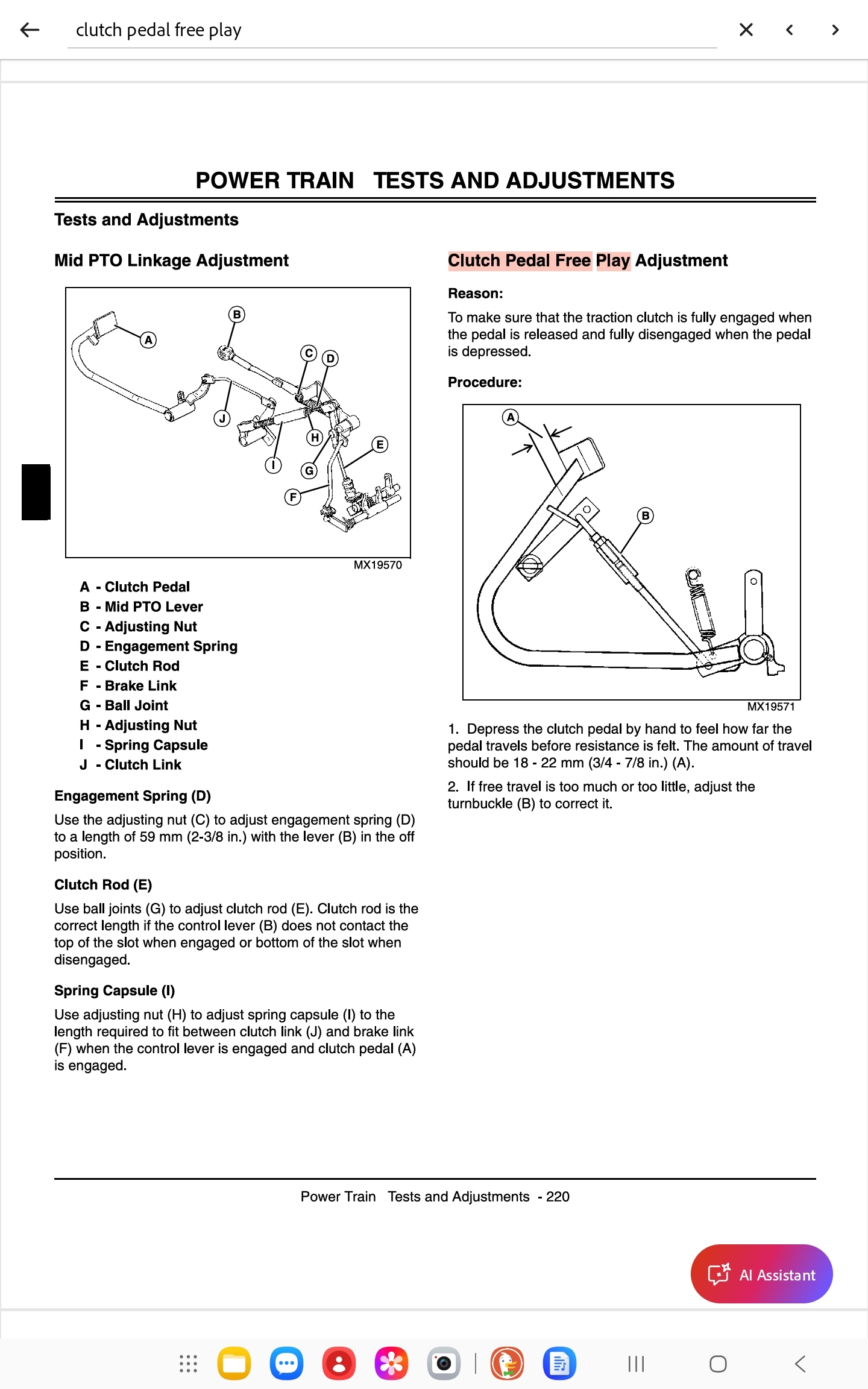

@beenthere I've been reading the technical manual and this adjustment falls in line with the video (see attachment).

I made adjustments according to the technical manual from a range of 5/8 to 7/8. I engaged the PTO with a slight grind noise which was less than before and released the pedal and it would spin. However when I depress the clutch pedal fully the PTO remains spinning. Additionally I still can't engage the PTO with an implement attached, only when there's no Implement attached.
   / JD 790 PTO Adjustment #15
You're describing pedal free play adjustment. What does you manual have on the internal adjustment? Assuming you've been there? Have you tried this? Working through the internal adjustment access hole, wedge a pry bar in the clutch/flywheel assembly to prevent the engine from turning. Block the clutch pedal fully down and engage the PTO. Now put a pipe wrench and cheater pipe on the PTO output shaft and see how much effort it takes to turn the shaft (or if you can even turn it). If you can't break it loose that way, you can adjust back and forth all day and it's not going to work properly.

I started with adjusting the free play because it was so extremely out of adjustment according to the technical manual that it may not be allowing the PTO clutch to stop spinning. I could not find anything on internal adjustments of the clutch, just the assembly and disassembly, and how it's engaged and disengaged. I'll be able to try your recommendation tomorrow. Other suggestions were to do something similar like a screwdriver to rotate the PTO clutch and adjust the gap on the three bolts associated with it to .055 - .06.

Harry in KY said it well, if it is true that the PTO clutch disks are stuck together. It may help.
You said you had downloaded the service tech manual. The dual clutch adjustment (not the pedal linkage) should be in that manual.
Post a link to it here if you can. Maybe we can lead you from there. You get at the adjustment nuts through the port holes shown in your first post. You have to rotate the flywheel/engine to get at the three adjustment points.
