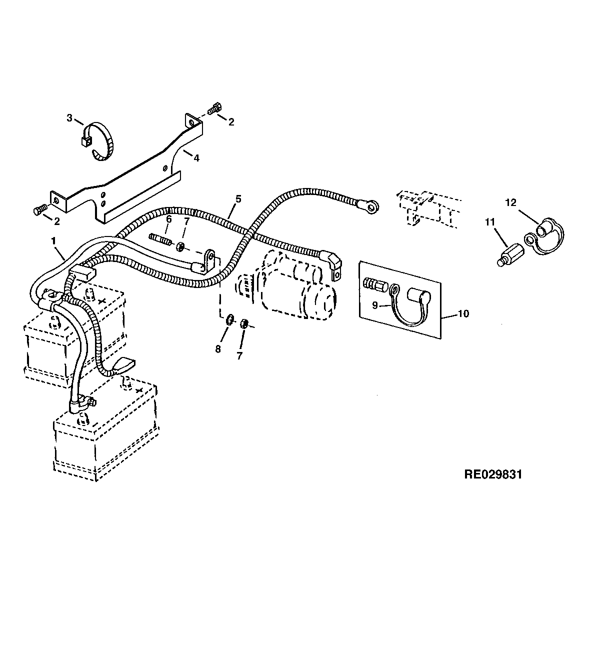

Just for clarification JD 7800 battery cable that attaches to starter is positive and cable to frame is negative.
parts key 1 RE34431 Battery Cable 1 X X X (A) (-)
RE39617 Battery Cable 1 X (B) (-)
parts key 5 RE34430 Battery Cable 1 X X X (A) (+)
RE48982 Battery Cable 1 X (B) (+)

Thank you, thank you, thank you-----Tx Jim Joatguy and Boggen !!
Finally got some time, so I put a light about the size of a license plate bulb between the ground post and ground and it barely glowed, so went to a smaller
dashlight buld which lit up pretty good.
Started pulling fuses and got to the one that said seat. This tractor has a warning on the dash if you get out of the seat when the PTO
in engaged. So I unhooked the little double wire going to the seat pad, plugged the fuse back in, that didn't change anything. This seat
also has many wires going to the air pump and bag in the bottom of the seat. Then I removed the fuse, hooked up the battery cables
and started the tractor. Everything seems to work just fine without the fuse and no battery drain. Sib

Thanks for posting your results, so many times we never hear what was found or how you found the issue.
