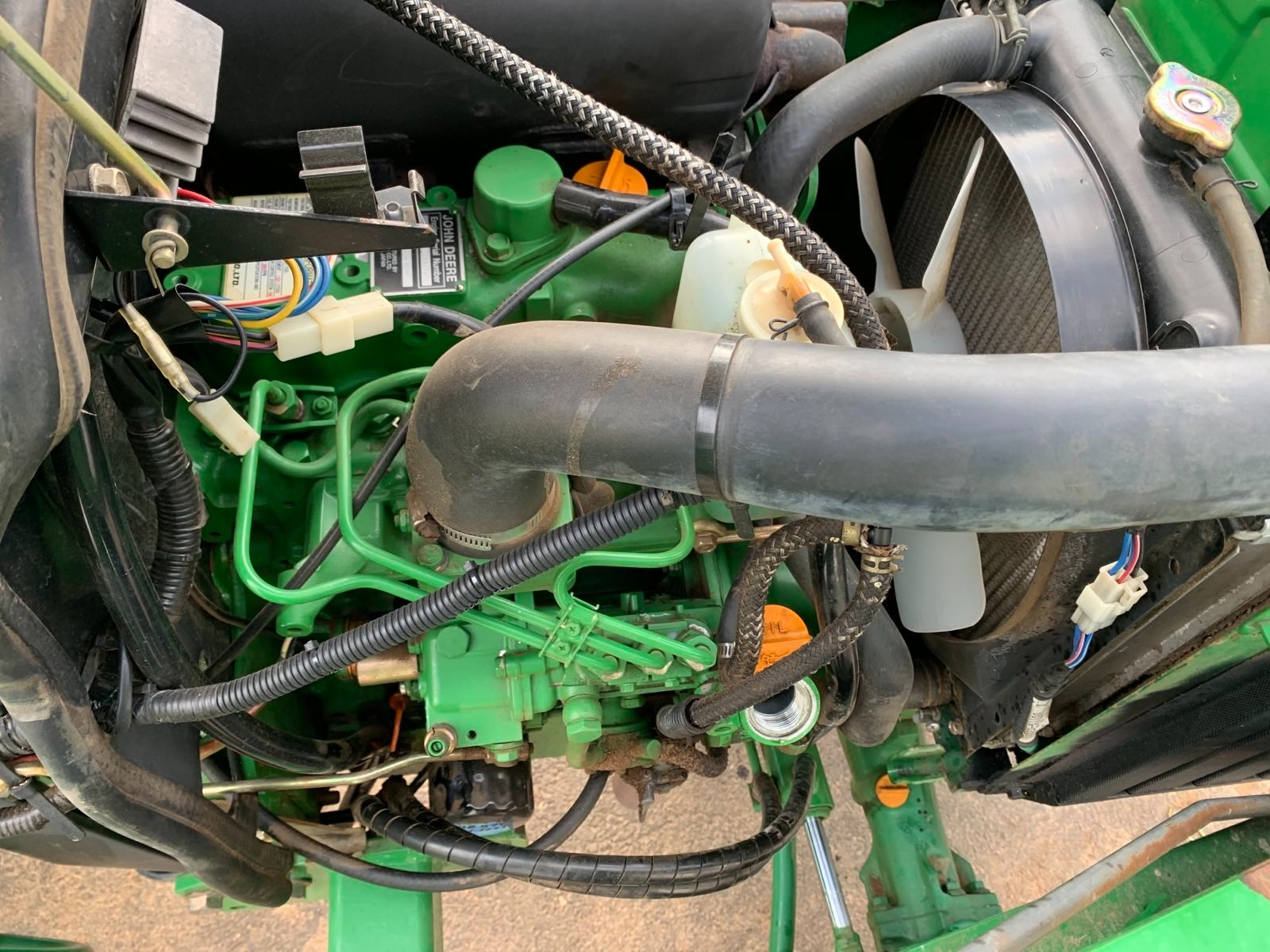

New to tractors and bought this 790 with 860 hours. I started to change all the fluids and i am stuck on steering fluid. I belive i read it is hydrostatic so i assumed it used the same fluid as the hydraulic system?
Then when i remove the cap to fill, no line to let you know when it full.

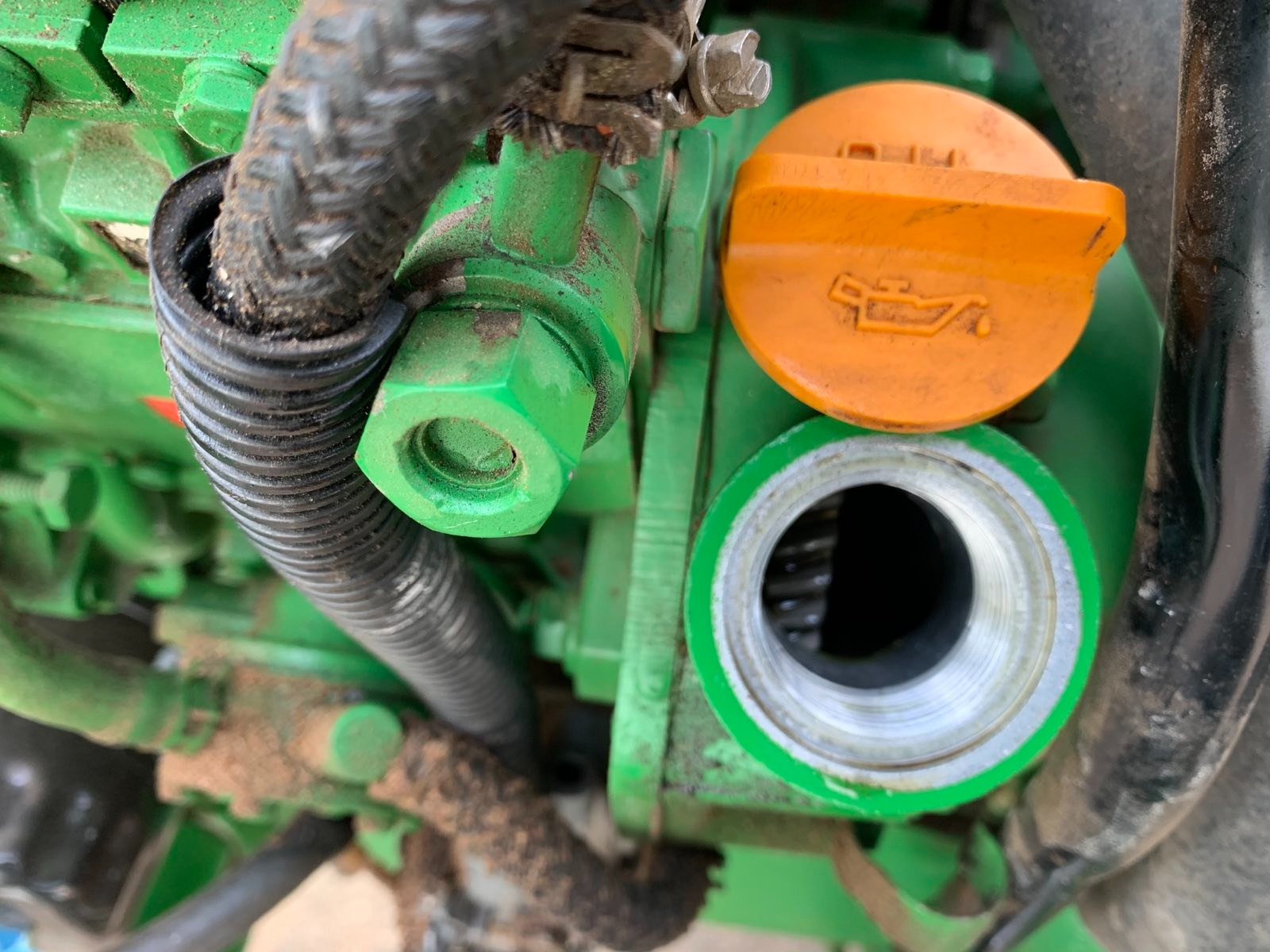

Ok i have changed Engine, hydraulic and the axle fluids , the confusion that i am having is what is that cap (in pictures) attached.
The upper is for engine oil. but the lower one with the exposed gear.
BTW i am having surging on the steering when turning some times is hard then its ok and it seems to change when with engine speed. that is why i am looking to see if it has enough fluid and or to change it.
thank you,

Google for a service manual, or maybe just call and talk to a JD service mechanic.
   / JD 790 4WD type and amount of fluid for the power steering #5
I don’t have a 790 but I’m quite sure that’s just a second fill port for Motor Oil
   / JD 790 4WD type and amount of fluid for the power steering #6
Both for adding engine oil.
Both same part # M805710

The second orange plug seems to me to be on the valve cover. If so, then yes, just a second option to fill up engine oil.
