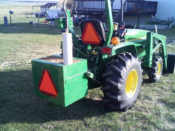

The previous owner of my JD770 had to repair the front gears around the 500 hour mark just before I bought it. He claimed that a snap ring had come loose in the front hub which destroyed both front gears. But after reading this thread, I wonder if he didn't just overstress the front gears by operating the tractor in 4wd on a slope with a full bucket of heavy material. He also didn't own a ballast box; didn't have rear wheel weights, and/or didn't have the rear tires filled. At best, he had an implement on the 3-point.
One of the first things I did after I bought the tractor was to fill the rear tires. I could definitely feel the difference with an extra 320lbs. Since I almost always have an implement of the 3-point, I would love to add weights to the rear tires too, but they are really expensive. But with the cost and hassle of fixing the front gears, I may just get them. My model 70 loader operator's manual recommends using a ballast box, rear wheel weights, AND fluid-filled rear tires. That is probably around 1200-1300 lbs total weight in the rear (the manual doesn't give an exact minimum rear ballast weight needed). It is possible there may be no amount of rear ballast that can protect the front gears on these tractors under all circumstances.

Just got my JD ballast box (24"x20"x18") today for my JD770.
