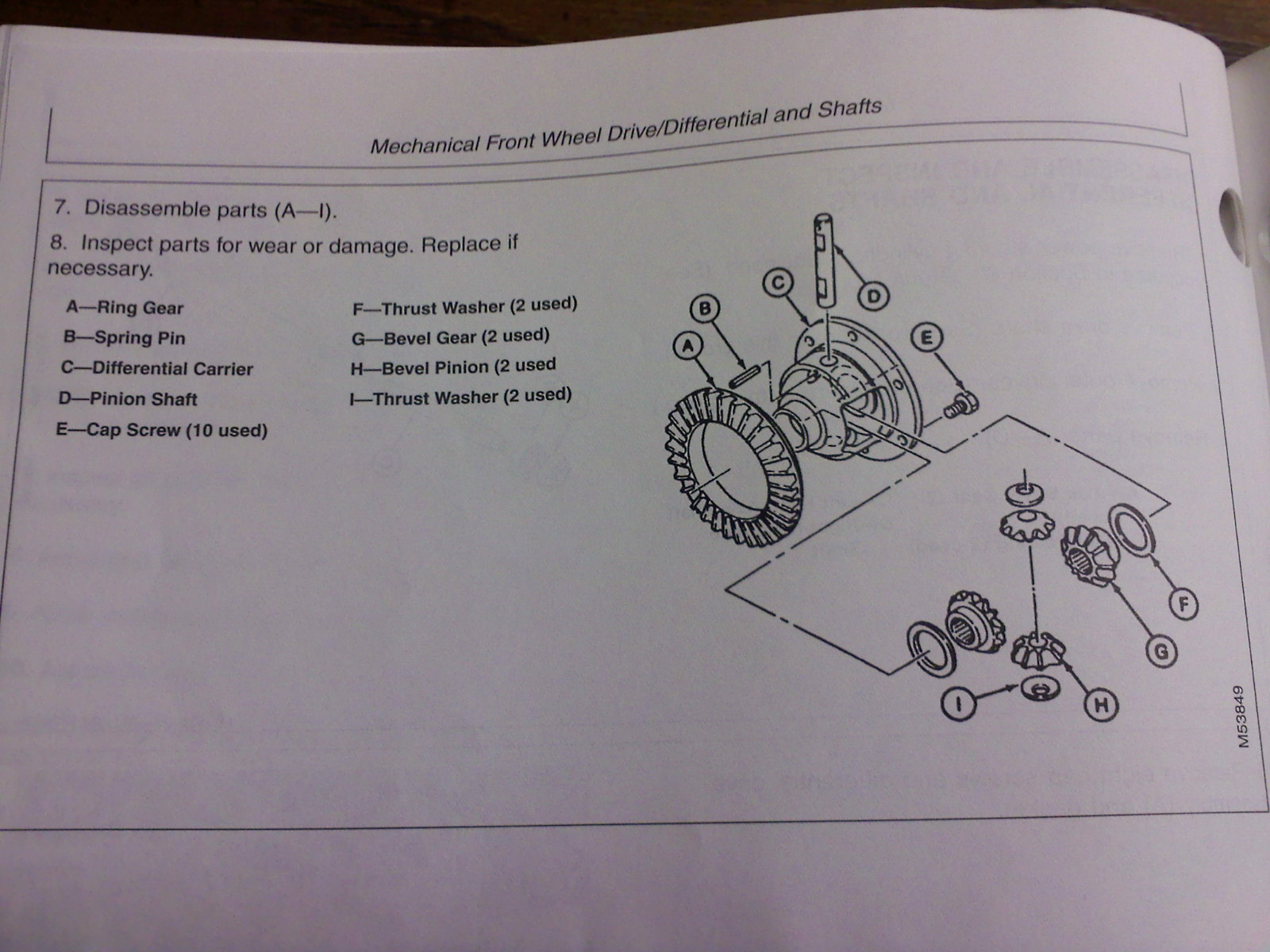

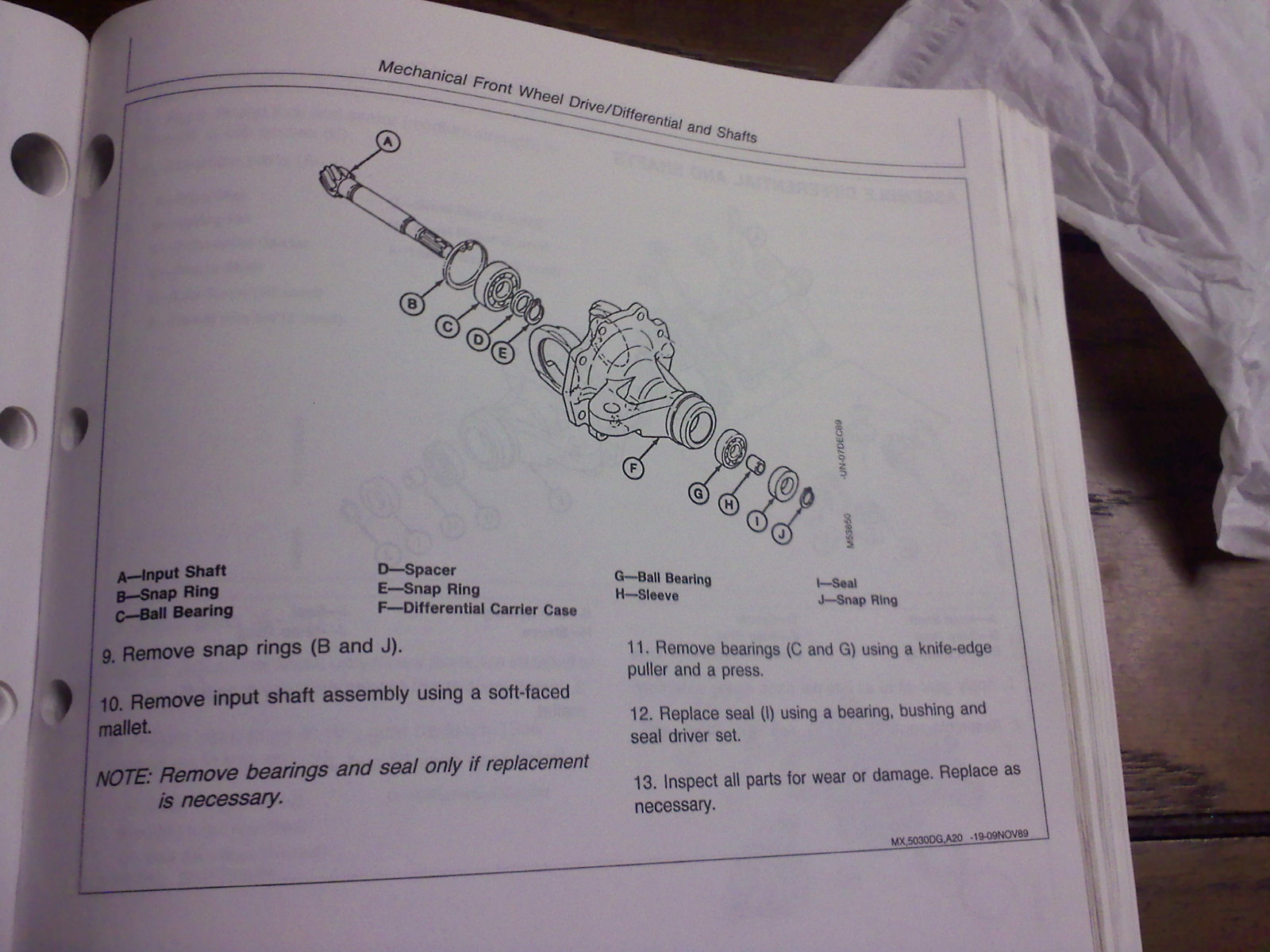

MinnyMoMan,
Attached are some pictures from the JD790 service manual on disassembling the MFWD differential and shafts. Let me know if you need more pictures from the manual.
Bruce

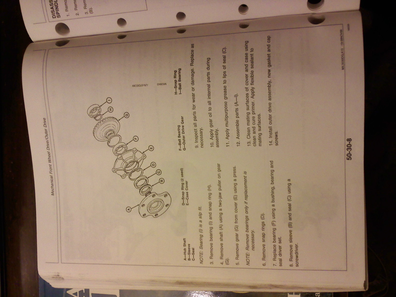

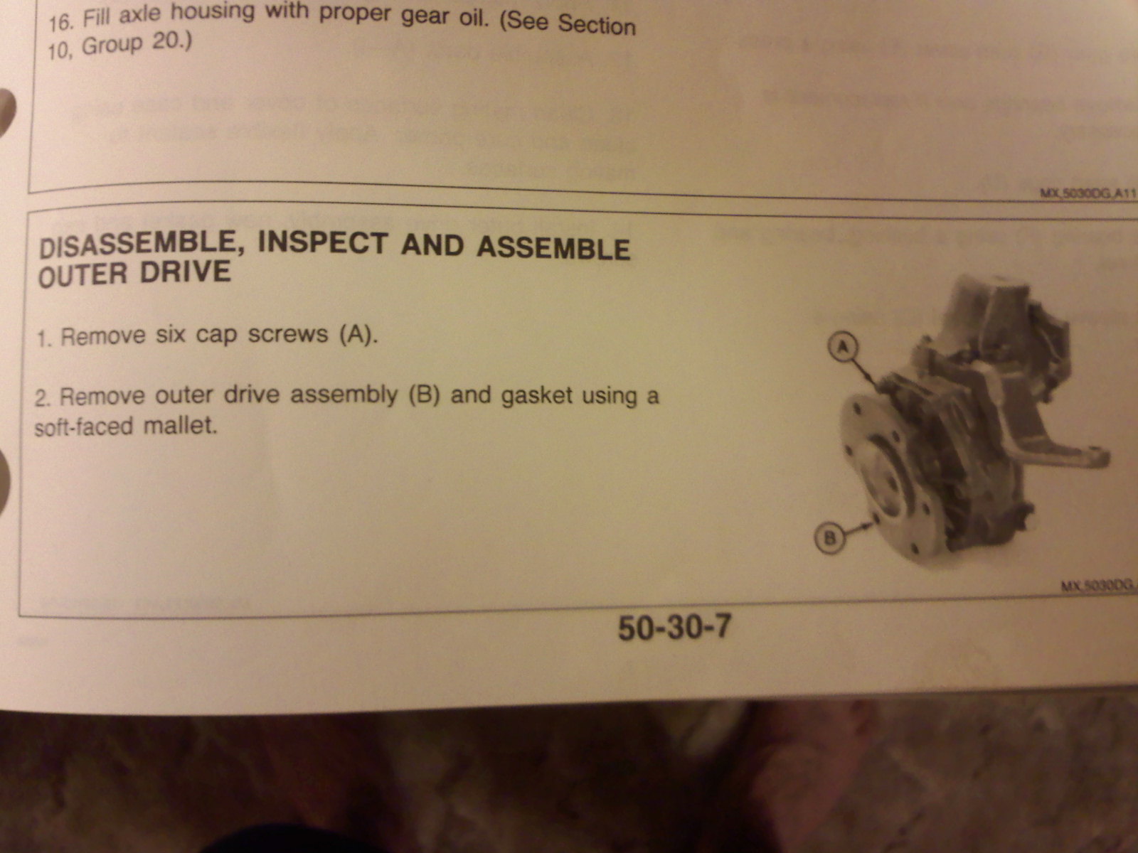

MinnyMoMan,
Here are some more pictures from the JD790 service manual on the outer drive and spindle housing.
Bruce

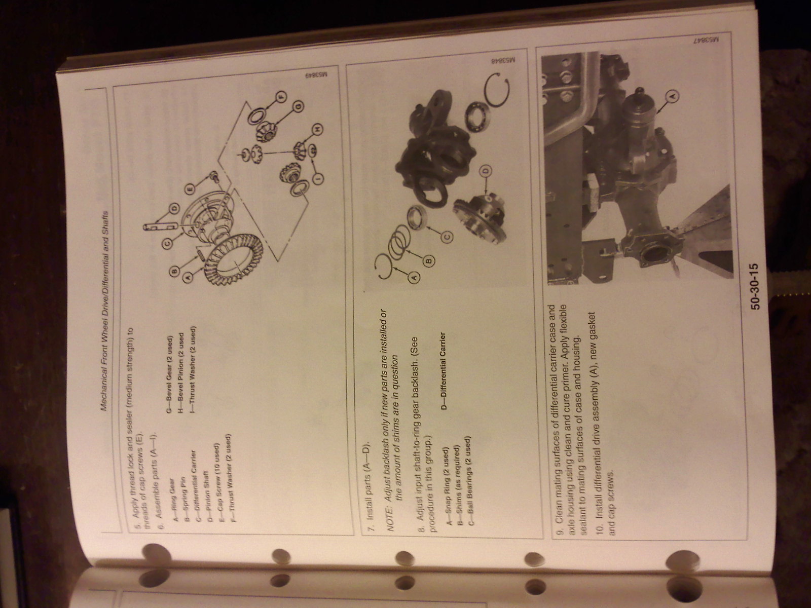

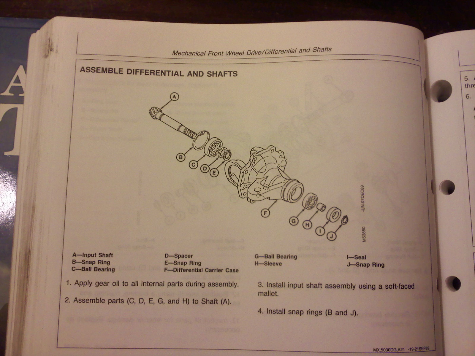

MinnyMoMan,
Here are some more pictures from the JD790 service manual that you may find helpful when you reassemble the MFWD axle.
Bruce
