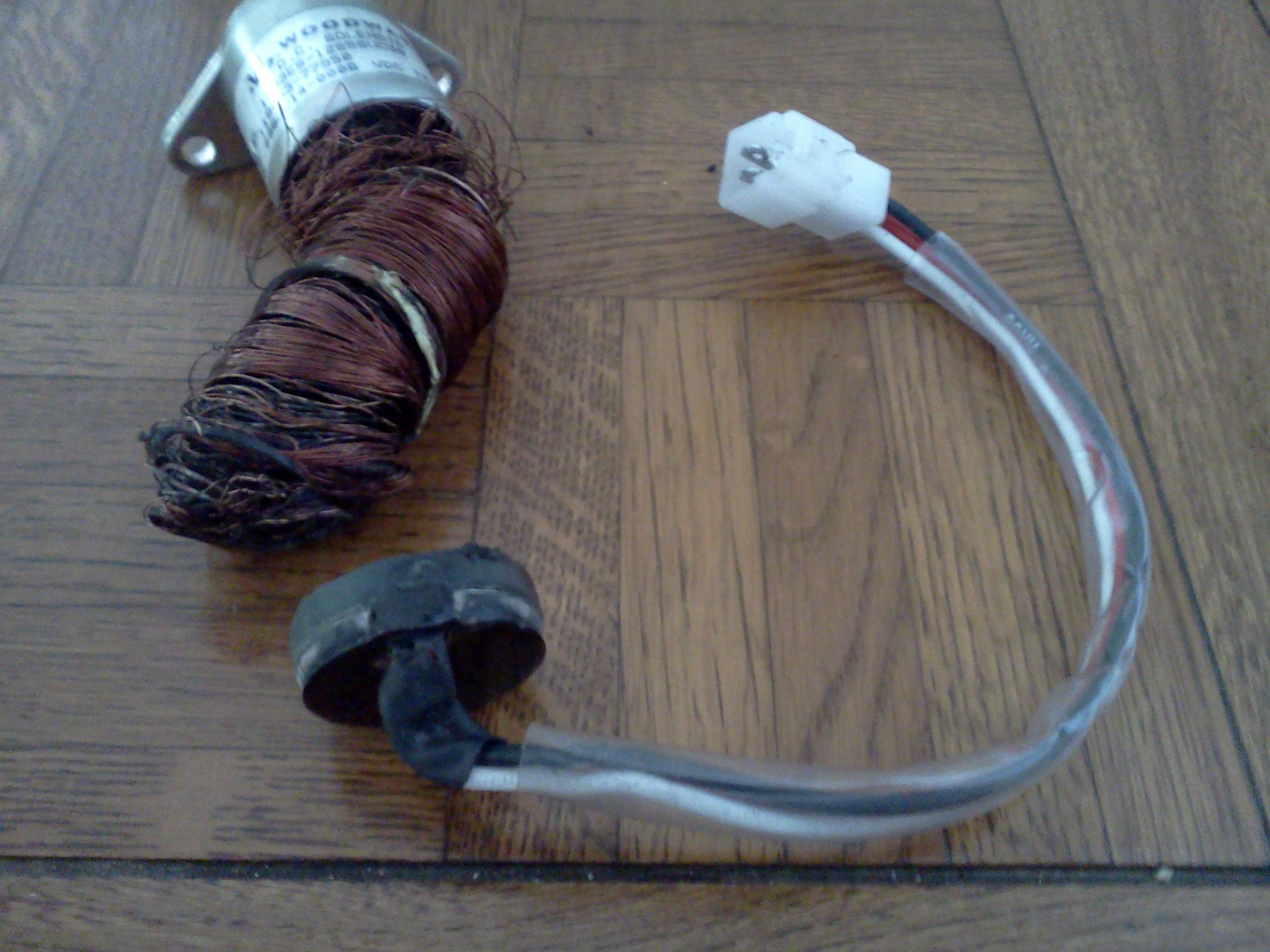

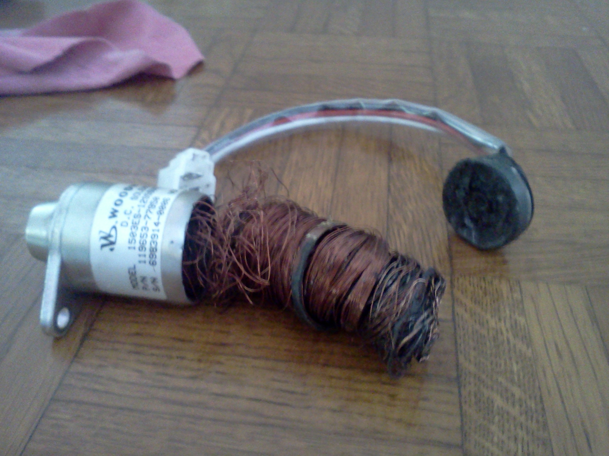

This is what the new solenoid looks like after my friend put it on and why I am trying to figure out what caused it.
