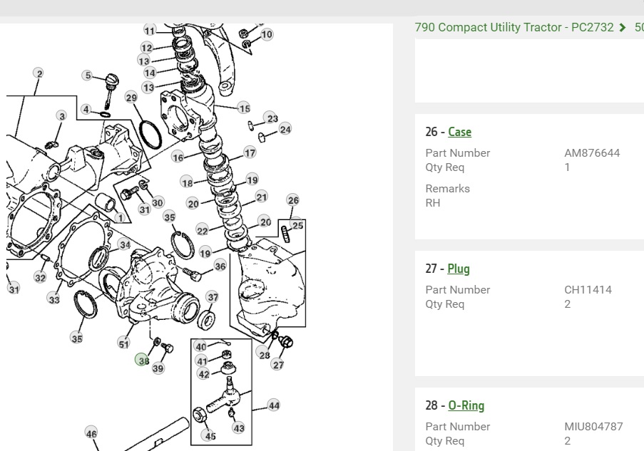

You cannot find the drain plug in the front axle?
Look low on the right side for the drain plug. Below the same side that the dip stick and filler hole are found.

Yes, and I have changed the axle fluid. I didn't realize this was the 4wd fluid. I'm new to this.
Thanks!
   / JD 790 How to change 4wd fluid #4
There is also the transmission hydraulic oil. Presume you know about that. The two fluids are separated by the front drive shaft.
You can browse the different parts of the 790 at this link..
