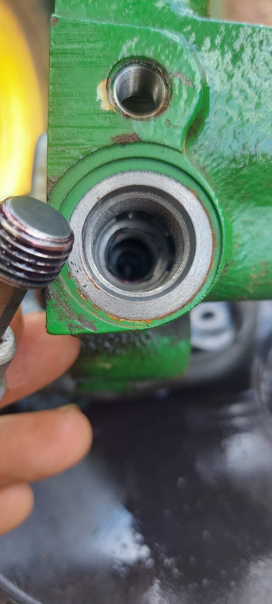

The loader will only function if the 3ph is trying to raise. If I hold back on the loader, nothing happens unril I move the 3ph handle, the the loader will rise until I let go of the loader control, and then the 3ph comes up to wherever I left it's handle. It's like the system relief isn't working and the loader only gets pressured oil when the 3ph relief is involved.

I'm currently pulling the rockshaft cylinder head off. The manual mentions something about either the relief bypassing, or the "SCV plug" bypassing if there's no pressure at the loader connections. Bad part is, the "SCV plug" is only mentioned in the diag and test procedures, nowhere else. 😬

Quick update, pulled the rockshaft cylinder head off, and out fell this plug 🤣. I'd bet dollars to donuts this is the "SCV plug" that sits in the bottom of that hole to prevent oil from skipping the loader. The threads were even staked, but it still backed out. So back in with red loctite and we'll see if it's good!

Fixed...

thanks for posting the pictures of the ultimate problem. My guess is that plug isolates pressure from 3 point when installed and may not be used on units with out auxiliary valves installed. Strange that you have to remove cover for access though.
