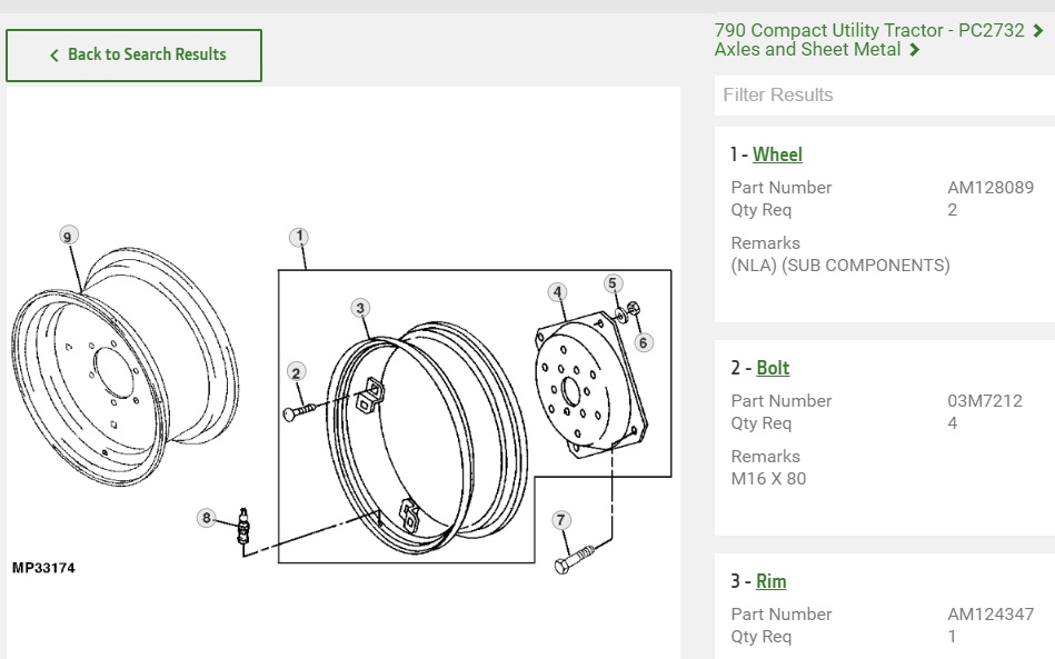

Jul 9, 2020 / JD 790 Rear Weights Question #1 F FarmKids New member Joined May 28, 2020 Messages 24 Tractor John Deere 790 Do I need to install wheel disk part M138917 prior to putting rear weights on my John Deere 790 or can I just attach them to the rim of the tire? Thanks!!!

Jul 9, 2020 / JD 790 Rear Weights Question #2 B beenthere Super Star Member Joined Aug 16, 2001 Messages 18,613 Location Southern Wisconsin, USA Tractor JD_4x2_Gator, JD_4300, JD_425, JD_455 AWS, added JD_455, JD_110, JD_X485(sold) Here is a pic of the M138917.. Do you see a reason to use it if you already have a rim (key #9)? Do you have the 60# weights that match up to bolt holes in your rim? Attachments 790_wheel_rim.jpg 100.2 KB · Views: 106

Jul 9, 2020 / JD 790 Rear Weights Question Thread Starter #3 OP F FarmKids New member Joined May 28, 2020 Messages 24 Tractor John Deere 790 beenthere said: Here is a pic of the M138917.. Do you see a reason to use it if you already have a rim (key #9)? Do you have the 60# weights that match up to bolt holes in your rim? Click to expand... I am going to order the weights and the hardware tomorrow. I just wanted to make sure I didn't need to order the discs, too. I am glad I don't because they are expensive.
