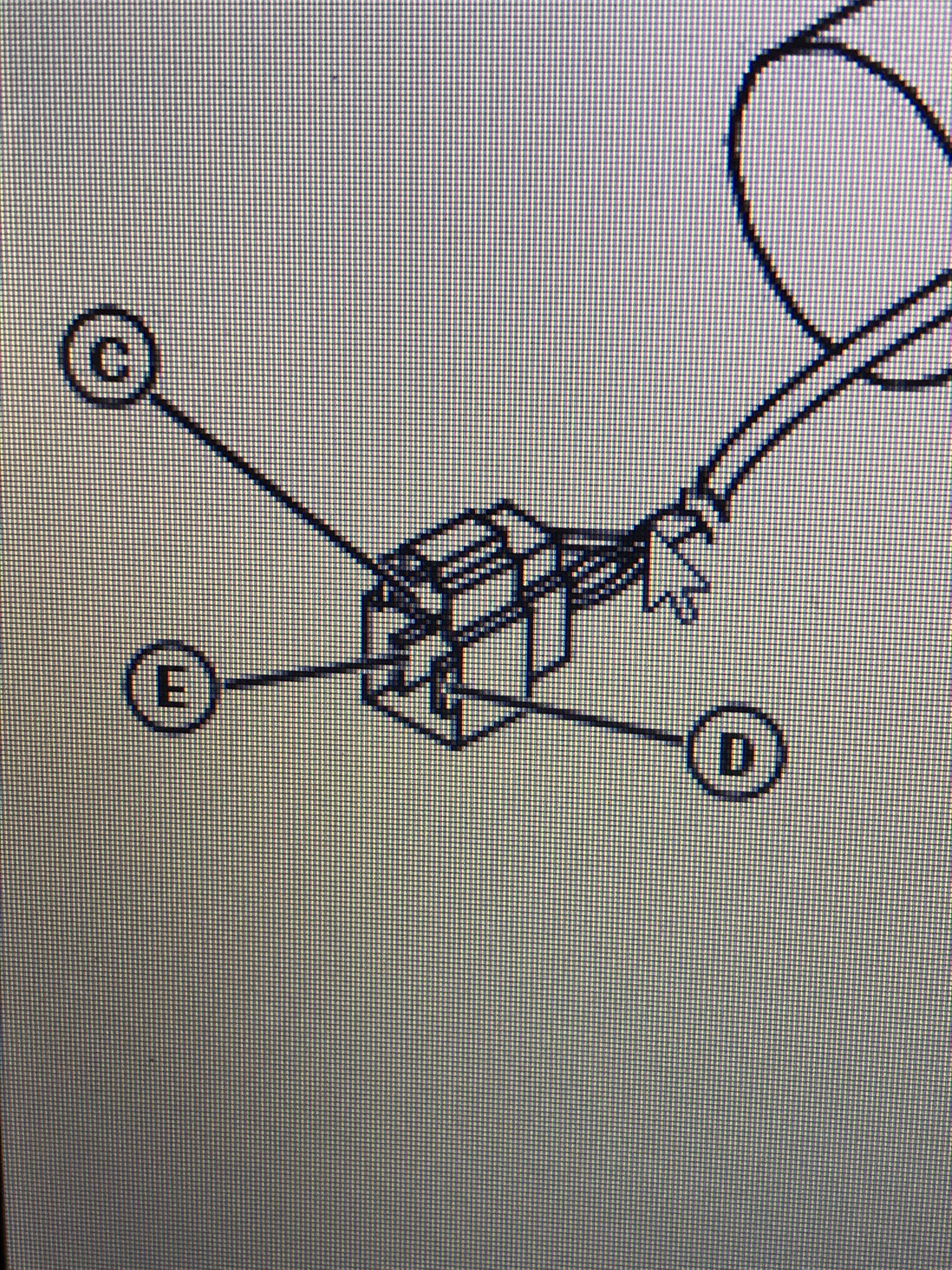

So check the resistance on the terminals in connector. Should be 3. See pic.
As stated in Tech manual some numbers don’t match so this is what you need to see if your solenoid is good.
Fuel shutoff solenoid—
C to D ..........0.5 ohms
C to E ..........23.5 ohms
D to E ..........23.5 ohms
