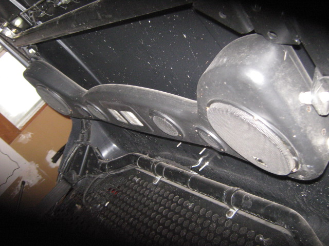

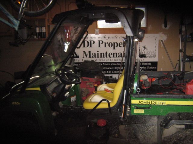

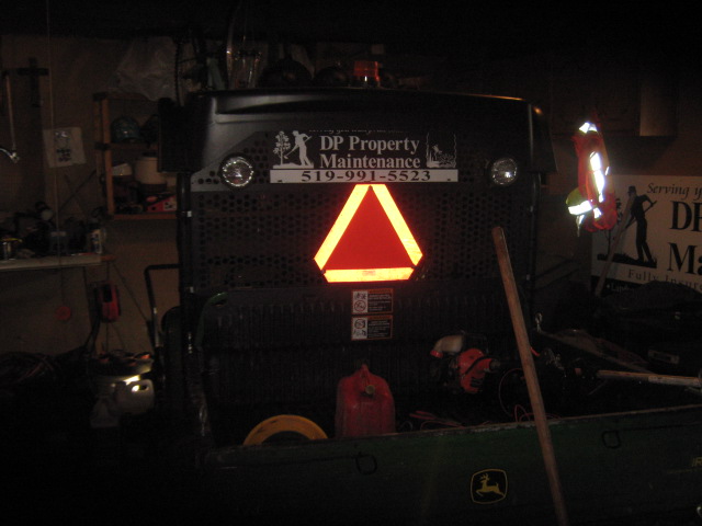

Not a lot of room to work with in there but I am so glad I got the 850 deisel model seems to be much more issues with the gas model the 850 is well worth the price . I did the front strut upgrade added the roof and windshield and an alpine stereo system with a speaker bar- this machine has been a workhorse worth every penney.:thumbsup:
