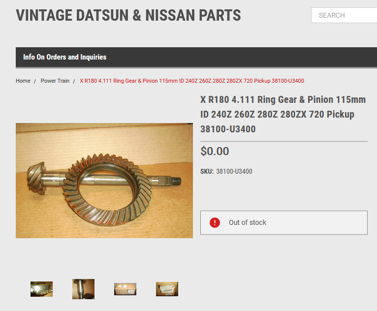

I have had a good bit of trouble on the 4x4 (MFWD) axle on my 855 John Deere. I have had it apart a few times for various gears griding. I am guessing the previous owner worked it hard without a weight box for the front end problems i've had.
Most recently my ring and pinion gear on the axle are shot (am875146). The going rate for this part from Deere is $2800...I almost fell on the floor...this isnt a semi truck, it's a an 8" ring gear! For comparison I checked on parts pricing for a few similar newer models, and the ring and pinion were $400, so something just seems way off on the part I need!
Has anybody been down this road with a better parts solution, or know if there is an identical Yanmar tractor that lines up with the JD 755/855/955.
Thanks!
AM875146
41 TEETH Ring Gear
8 TEETH Pinion Gear
If sizes were known, it would be better to find the Yanmar equal.
These are just examples from a Yanmar F & FX series machines of the same era.

Indeed.
I know the Yanmars and Yanmar made Deeres of that era were all automotive based ring and pinion gear sets. Yanmar tended to use parts from Datsun motors (today called Nissan). We know these things came off of the late 70s and thru the 80s Datsuns for our tractors,
- Headlight assemblies
- Horn
- Alternator
- VR (voltage regulator)
- turn signal flasher solenoid
- gears from the 521, 620, and B1110 pickups
So, if we knew some measurements, chances are, those parts can be had at AutoZone, NAPA, etc.
Example of a Datsun set,

Yeah. I suspect - based on nothing :) - that the first generation Powershift is an automotive A/T minus the torque converter. Or at the minimum, the Powershift internal clutches came from there. Also the clutch disk and pressure plate at the flywheel. And there should be some PS rebuild parts in common.
   / JD 855 4x4 Axle $2800 ring gear!?! #20
I had poked around on Rockauto.com for Nissan/Datsun 1971 thru 1974 and fond some part numbers to search on. It was indeed a surprises to see the B110 and 720 parts to mimic those of the Yanmar/Deere parts.
So, if the original poster can take the normal measurements of the worn parts, chances are he could locate exactly an automotive Japan vehicle match up.
On the Polish tractor forum, some of these Yanmar F & FX, Deere 55, 70, 90 Series have electronic relays. Its been fun finding the automotive equals too.
