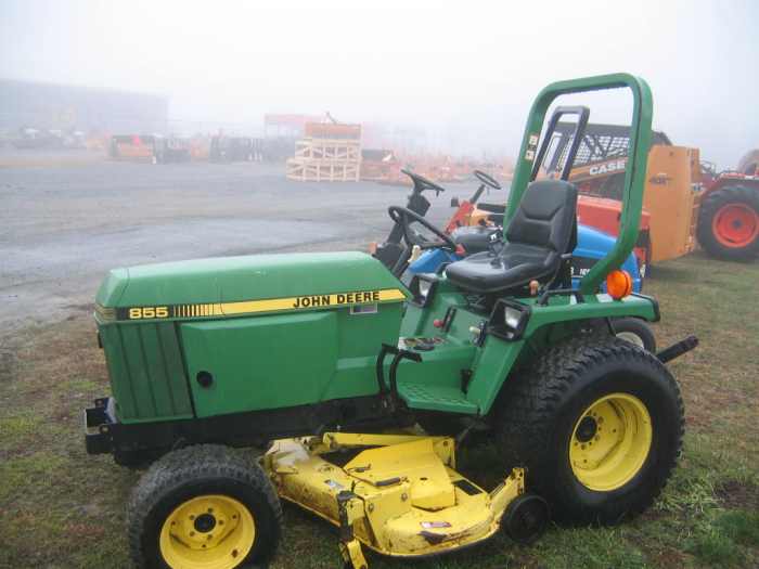

Hi Everyone.
i have been searching for a compact tractor to use around a small farmette I bought last year (15 acres) I plan to have some livestock next year and really am planning to be ahead of the game a little. I don't want to shell out the cash for a new one.
I ran across a Deere 855 with a belly mower at a dealer the other day. It is in overall good shape I would say. i didn't drive it yet but I will. They are asking $4995. The price seemed OK to me really. the belly mower needs some help and there is a crack in the hood. it has 850 hours on the meter. I am told it runs great with no known issues.
I would like to eventually buy a FEL and a brush hog, possibly a front blade as well, for use with it. can anyone comment on how these machines are reliable wise and if the price is OK.
Also anything I need to look at to check out on the used machine. I will TRY upload some pictures after this post.
Thanks

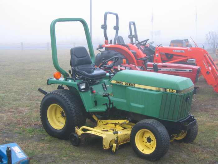

another view

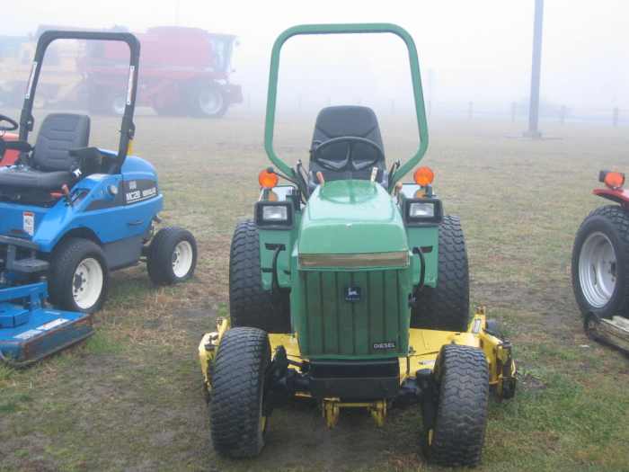

other side

For a tractor, you should be fine. If you want a FEL then I'd get it in a package deal. Much better economics. Adding a FEL could be expensive, unless you get a good deal on eBay or are lucky finding one sitting unattached. But unattached FEL's are rare, I believe.
