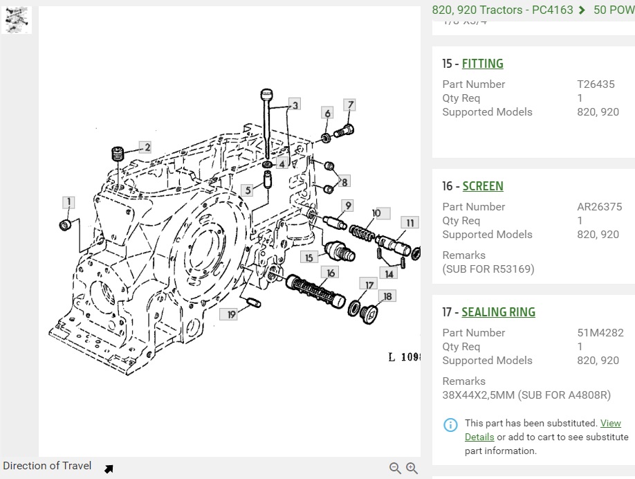

I suggest to R&R both rear axles to check/R&R brake pads. I also recommend installing bovine magnets in bottom of trans case where hyd oil screen is located.

   / JD 920 hyd system question #7
I guess the owner doesn't have an operator's manual. The op manual shows how to adjust the brakes for wear - and doing that will tell you if they are worn clear down. Seems an odd thing to have a dealer check. Funky probably means milky - which means water in the trans/hydraulic fluid.

   / JD 920 hyd system question #8

The only adjustment for the wet brakes on a JD tractor of that era is adjusting operator pedal height if height is incorrect & bleeding air out of braking system if air is present. No other adjustments were available. Any tech manual designed for a 20 through 40 series JD utility tractor with open center hyd system should be fine. I have a tech manual for a 2040 that covers the open center hyd system. I just sold a Koyker loader that would fit that tractor for $2000,
