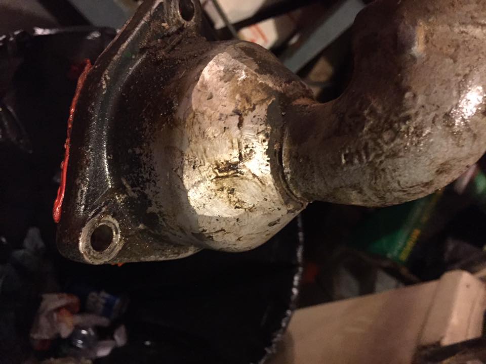

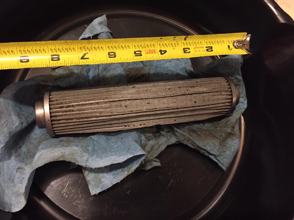

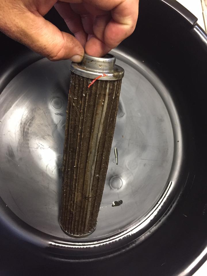

Just picked up an 85 950 (s/n 24055) and it came with the same Manual. The FEL and BH were very slow to move and actually stopped moving all together yesterday. It was low on fluid so I added about 3 gallons but then continued failing to act. I decided to dump all the hydraulic fluid and start fresh. I searched and searched for the filter and/or screen today because that's what the user manual shows. Finally, I found a picture online that shows the 3 bolt "cap." My cap though, instead of a plug had a large hose attached to it with a plug in the other end of the hose. I can only assume they used the hose as an attempt to drain the fluids. I pulled the cap (and hose) and drained the system of upwards of 6 gallons of some of the milkiest hydraulic fluid I've ever seen. The screen had a snot like substance on it as well. The screen will have to be replaced as it has some dents and one part of the cover appears to be tore out.

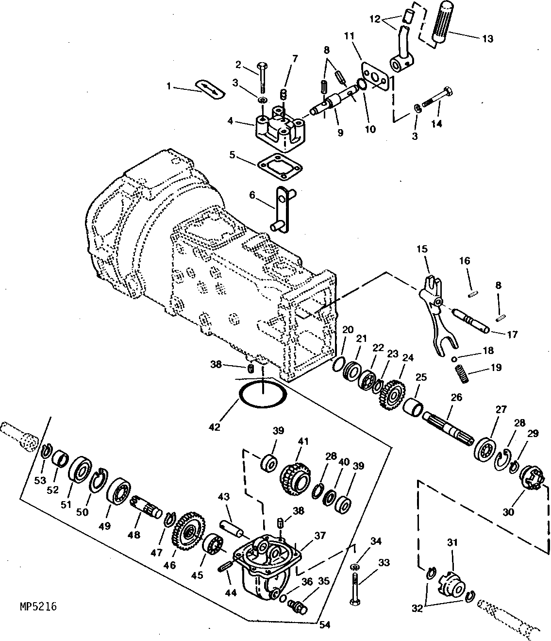

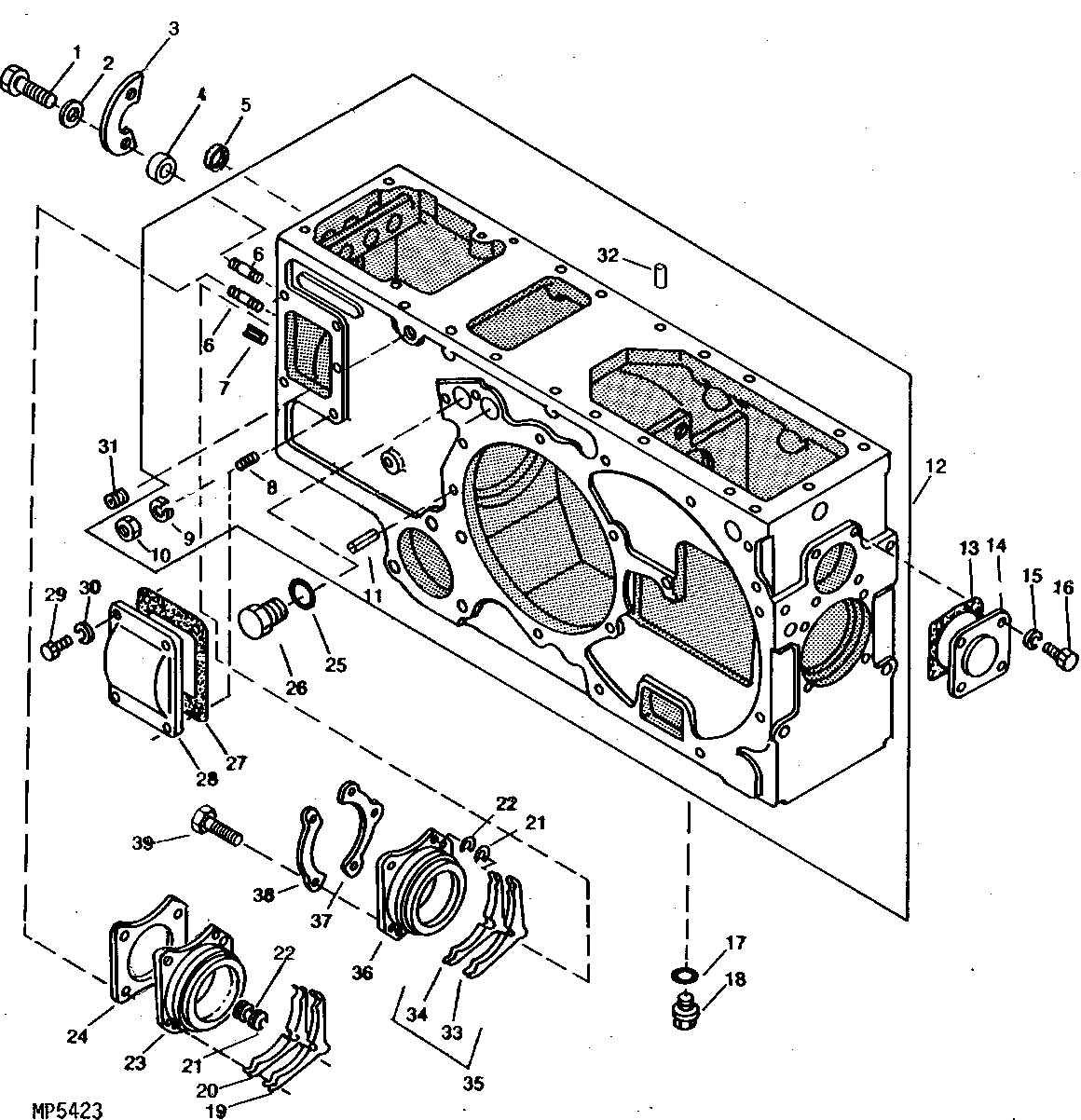

Classic pics of the 'snot' effect of water in hydraulic oil.
Your 3rd pic shows some modification to the end-cap of the suction screen with an 'elbow' fitting seeming to have been welded and filed/ground smooth.
Not sure why you can't find drain plugs. The machine is festooned with them.
1.In the centre of the Rear Transmission housing, Item #17/18:

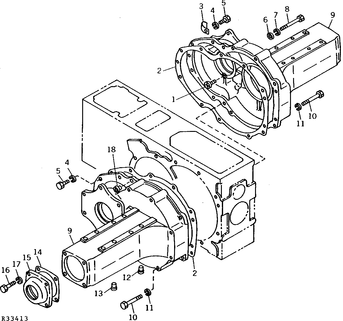

2. On (under) each Rear Axle Final Drive housing, Item #12 or 13:
3. If you have the MFWD there is a drain plug on the Drop-Box, Item #35:

Thanks for that Spanner. I do not have the screw on filter. I went to the JD dealer today and picked up a new screen, waiting on the o-ring. The end cap is no longer available so I'm hoping the cap was threaded and I can take the elbow off to replace it with a plug or leave the elbow on and plug the other end.

Yes, that cap is threaded - You can see the pipe plug in the LH cap in the second pic in my post #11 on this page. (Item #32)
