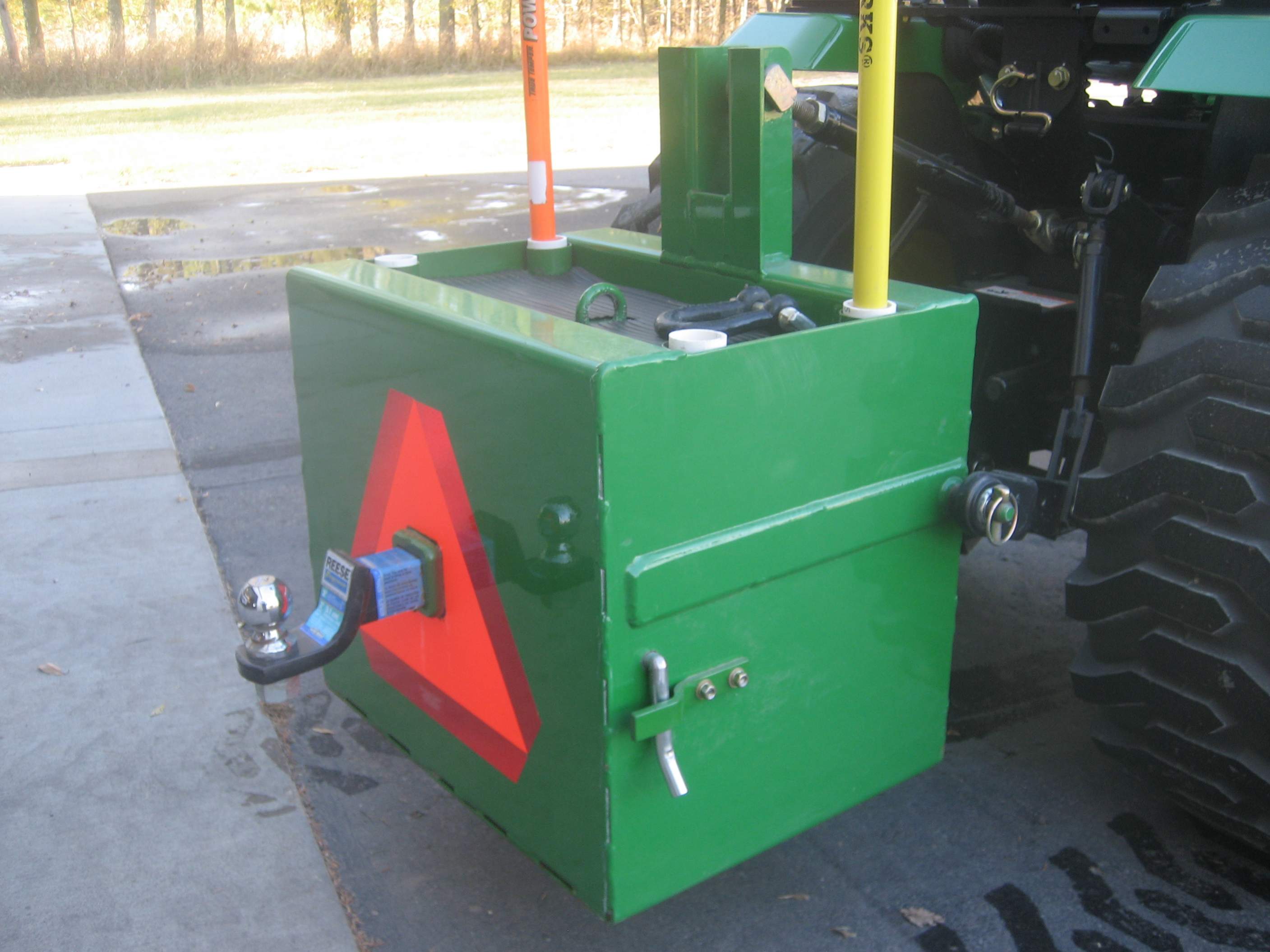

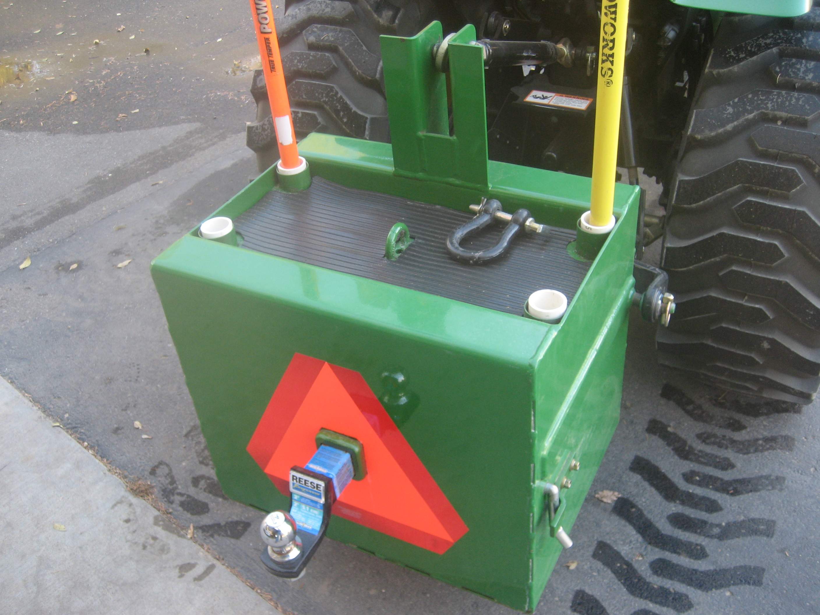

I am aware that this is an old subject but after viewing ideas on modifying ballast boxes, I finally got around to modifying my ballast box with a couple ideas of my own. Also filled it with concrete. Here's a couple pictures, sorry I didn't take any pictures while I was working on it.

Looks great ron, I especially like the insert retainer pin idea, that has to be a first, or at least I have never seen it before.

JB, Thanks for the compliment, I hadn't seen the retainer pin idea either, I came up with that on my own. There's quite a maze of metal inside the box, I used a piece of 3/4 pipe as a sleeve between the receiver and the side of the box for the pin to slide through. I was going for a nice clean factory look, at least if you didn't know any better it would look factory.
You could mount a receiver on top of the box as you said and then use a drop type hitch in it, the type you'd use on a higher truck. Just a thought.

If you look at the lifting loop closely, I have a hole in the middle of it. The loop is a small clevis welded over piece of 3/4 pipe which goes all the way through the box to the bottom with a drain hole drilled in the bottom of the box, allowing water to drain out that would get on top (snow, washing, rain, etc.).
The pipe is welded to the reciever inside the box and I have several fins welded to the pipe to lock it into the concrete.
Also drilled drain holes in the bottom of each tool tube.

a) First off, did you polish that BB before the pics. I can see the reflection of the hitch off the back of it. :thumbsup:
b) Second, and I apologize (it has been a long week)...but is your hitch permanent within the 2" receiver? I think I must be overlooking something since the retainer pin is mounted on the side. Please help me understand. :confused:

Not to speak for the original poster, but that pin you see goes all the way thru a sleeve to the receiver, which is pretty slick.

Thank you. Once I enlarged the picture, I understood how that works now.
And Ron,
WOW. That sure is sweet. What a great way to incorpate the hitch/receiver inside the BB. Thank you for posting!

Thanks JB, that is exactly right. The pins is roughly 14" long, and yes it does go all the way through the reciever, I welded a 3" sleeve on the opposite side of the pin

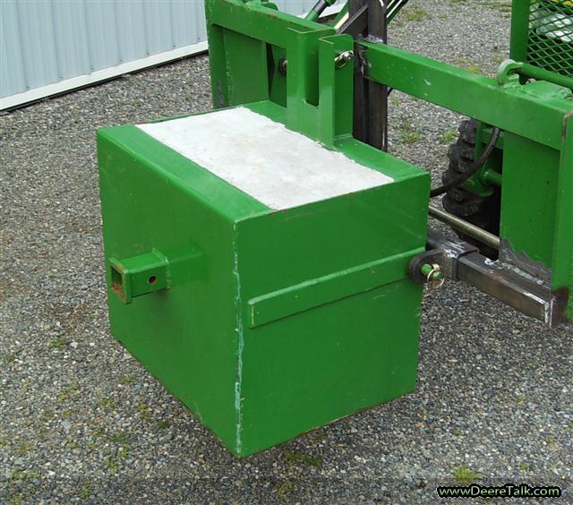

Looks good Ron. Wished I would of done a lift hook also.
Here's mine.
