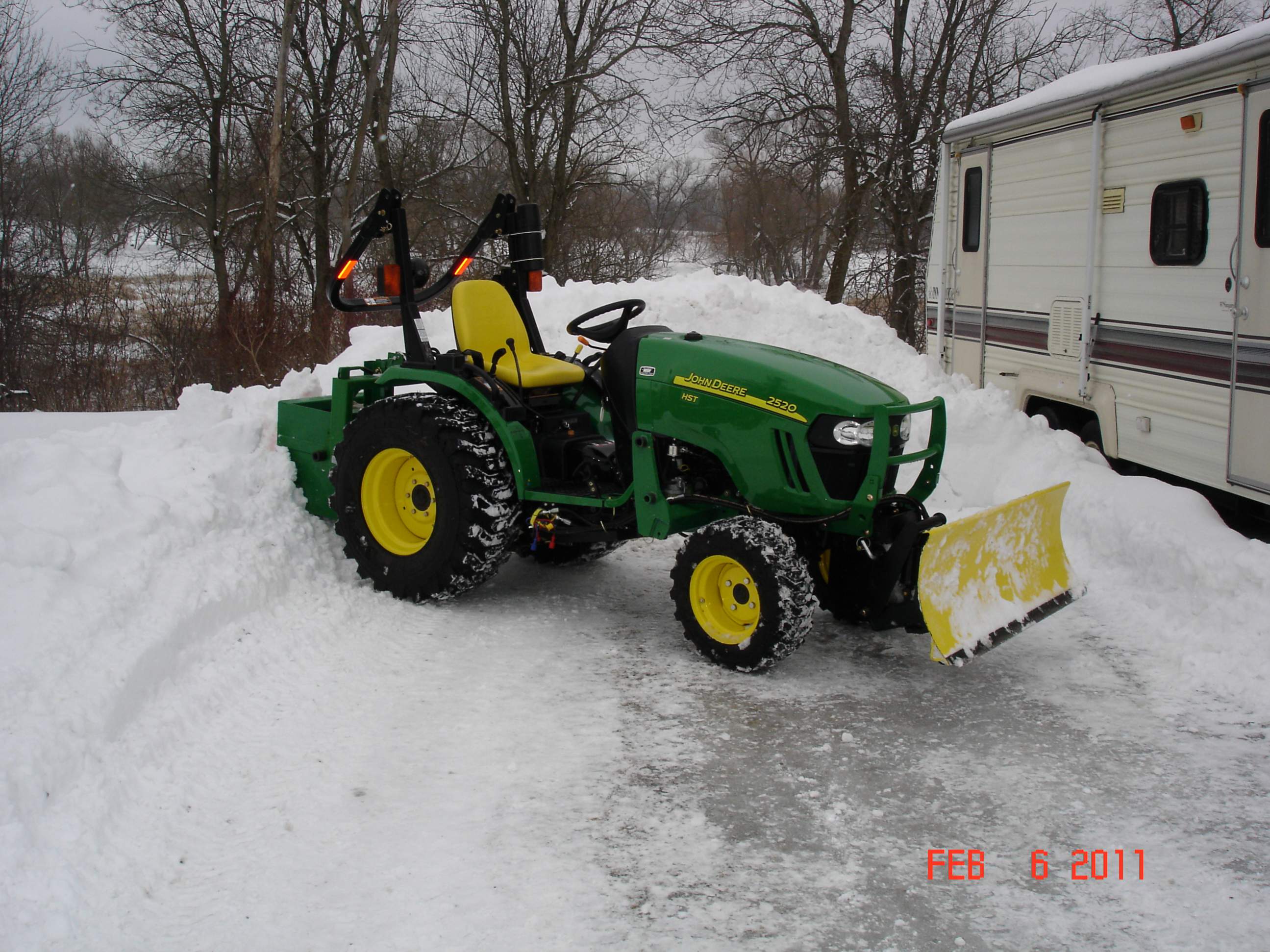

I used to use my X495 for plowing snow, as I have the 54" blade set-up, but it being only a 2wd, I had to use chains on it for plowing. I bashed around without chains for a season or so, but eventually realized I had to run chains. When I traded the old Yanmar in on the 2520, I upgraded the front hitch from the 495, for one to fit the 2520, and now, use the bigger machine for snow removal. The extra weight of the machine, and of course the 4wd sure makes a difference in the snow season.

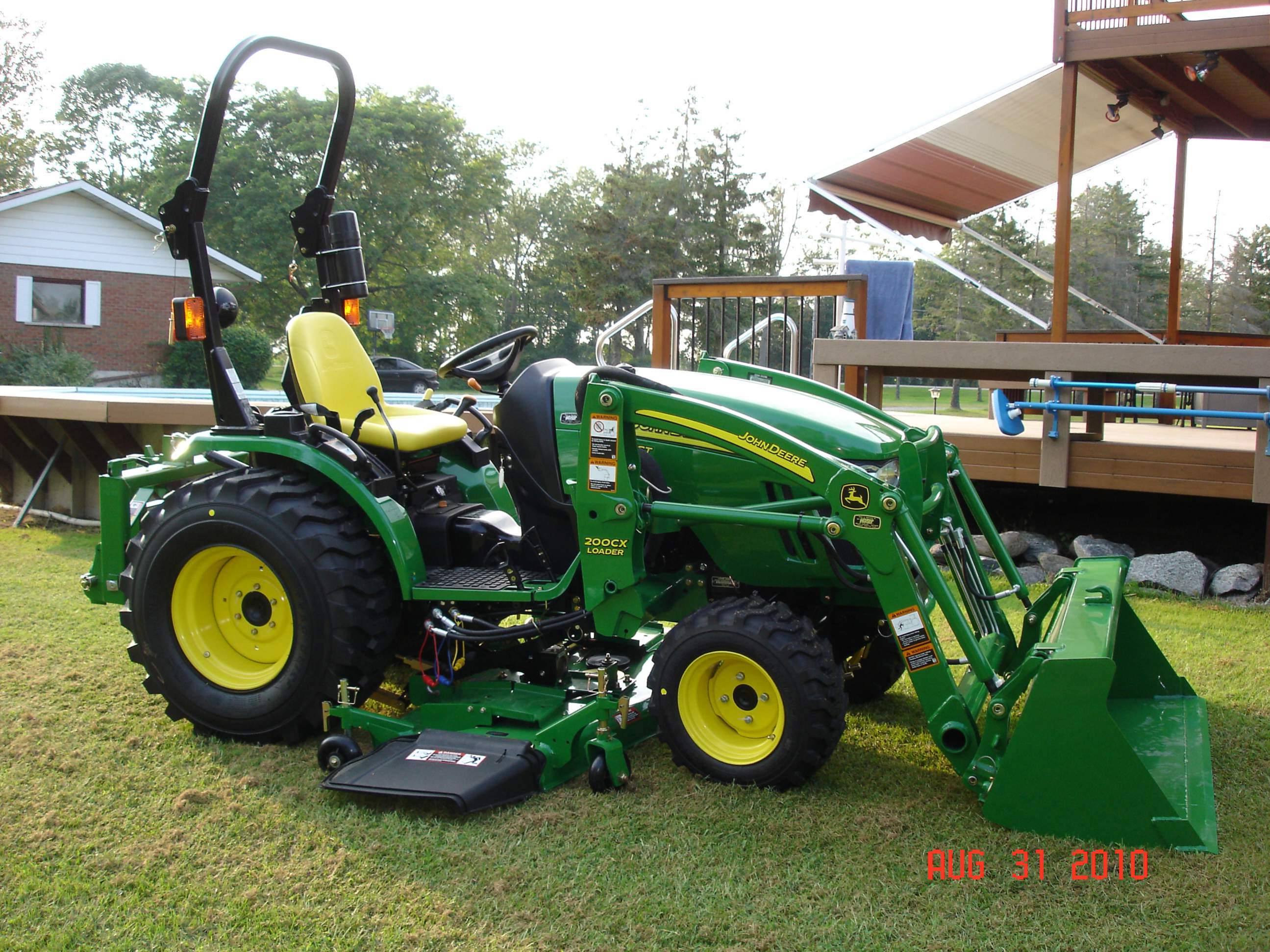

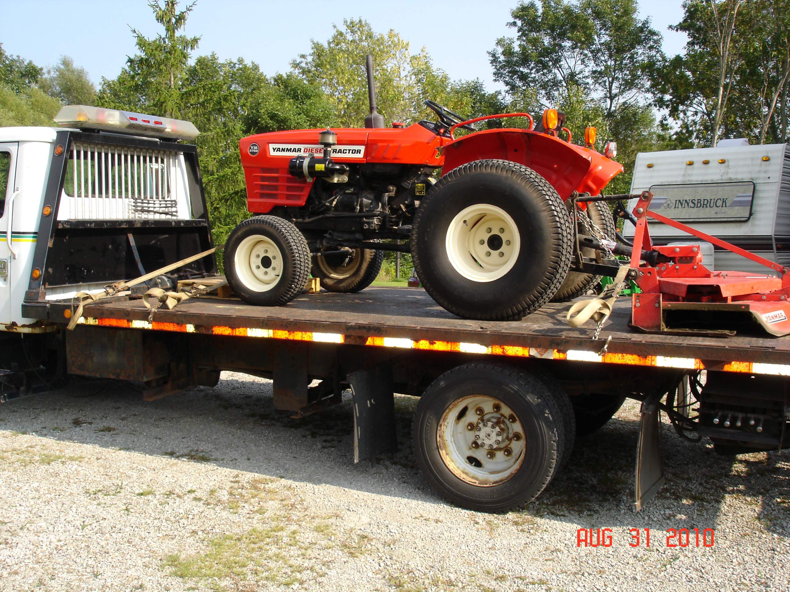

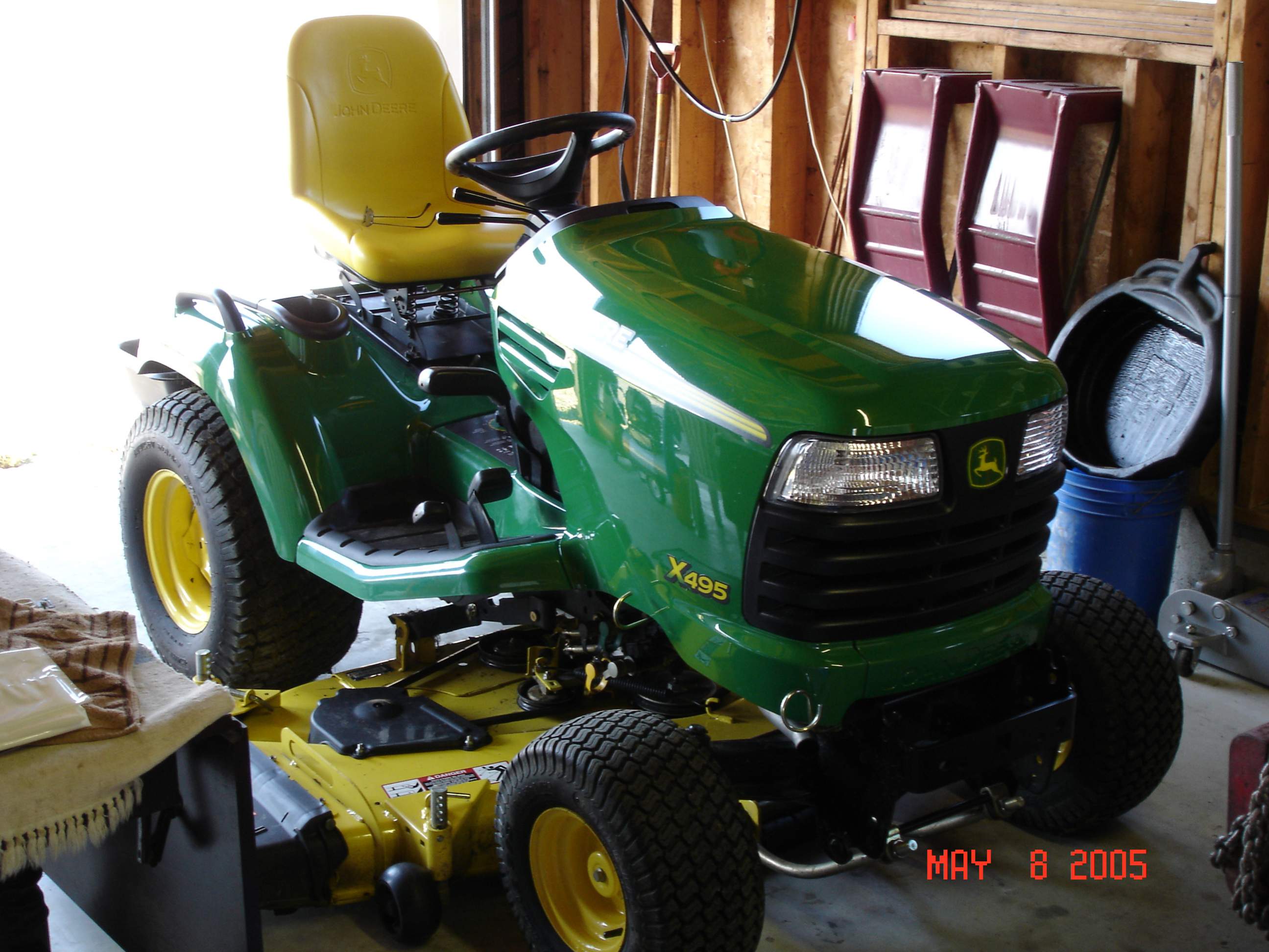

Here's a few pics of my old Yanmar & X495, and the new 2520 dressed out for summer and winter chores.

REV,
Nice clean looking tractors I'd say.:thumbsup:
Upon close examination of the pics I did find a few specks of dirt on the mower and I am not going to tell you where it is.:D
   / JD Diesel Garden Tractor #9
REV,
I used that old Yanmar on the truck.....that was the day they delivered my new 2520, for 28 years, and she never spent a night outside. Probably a good reason why I got a decent trade value. In a way, I kinda' hated to see her go. I guess the moral is that it pays in the long run to look after your stuff.
