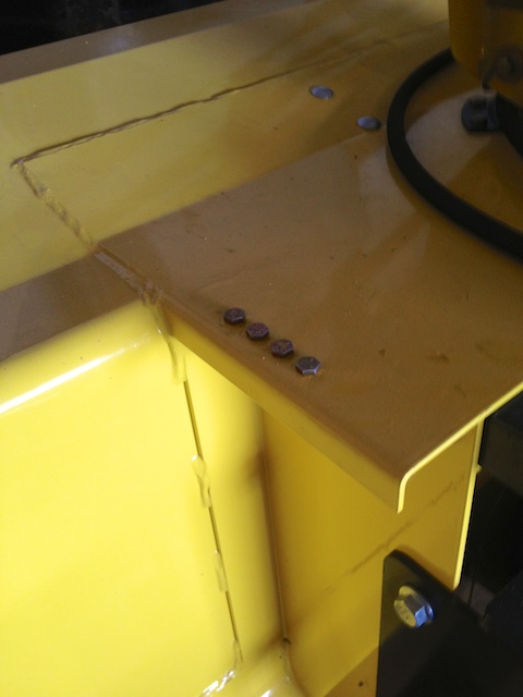

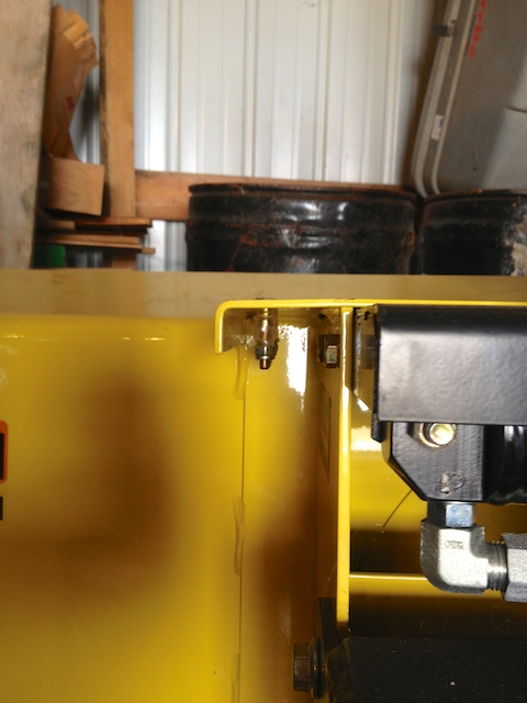

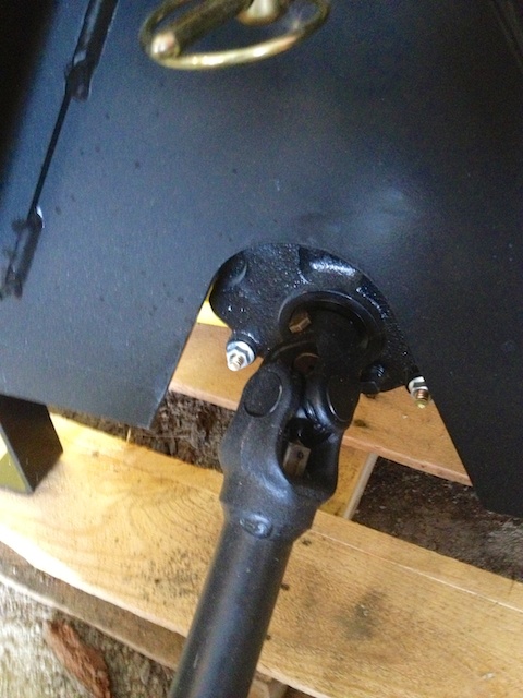

I think whether you have shear protection or not depends on how old the blower is. I bought a new 59" front mount this summer for my 3520 and then moved it to my 3720. As you can see in the uploaded pictures the driveshaft does have a shear bolt on it. This is where the driveshaft connects to the shaft on the gearbox. The blower itself also comes with four extra shear bolts that are bolted to the body of the blower. The pictures that I uploaded show both.
As a few on this thread I also believe that the John Deere engineers are continually evolving a product line as they get feedback. I have not bee able to use the blower yet, but hope to this winter, then I will be able to better comment on the operation and if I experience any issues with the shear bolt setup.

Good photos dschuffert, thanks for those!
By my count that's at least three places for shear bolts on this blower. The other two I noticed were on the main auger itself if I remember correctly. You'd think that'd be enough shear points.

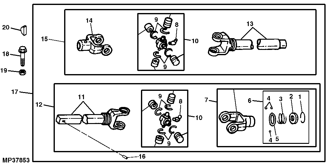

I think you'll find that what you're looking at is not a shear bolt. If the key was not installed, contrary to what the online Deere parts manual shows, then you can experiment with that bolt acting as a shear bolt. I had no luck doing that. The spare shear bolts you refer to are for the auger and have been there for a long time, it's the impeller that is missing protection. If you have a look at your operator manual it will likely only reference the shear bolts on the auger. If it mentions any other shear bolts please let me know and I'll discuss it with my dealer.
Here's the key part number from the manual and attached is the picture from the parts manual showing the driveshaft you mentioned.
20 M84550 Shaft Key 1 (3120, 3320, 3520, 3720 CUT)
