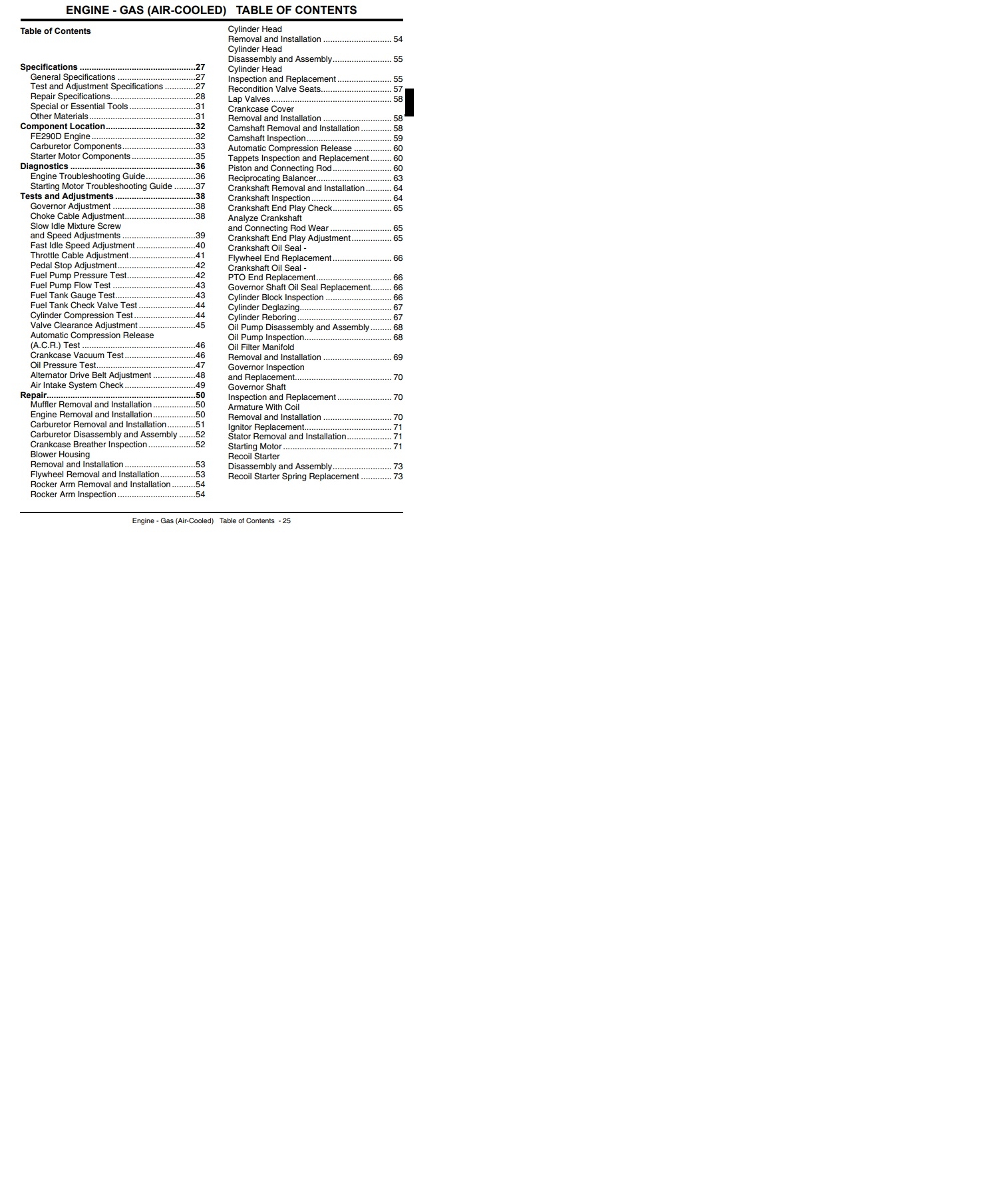

/ JD Gator Manuals ? #8
My 4x2 '98 gator has never failed to fire right off. But it never sits for more than a two-week period before getting some use. Never has had ethanol fuel in it either, so I suspect that is a big possible problem.
The TM1518 is the service tech manual of May '05 that I have. There are 45 pages on the gas engine air-cooled in the 4x2 gator. Table of contents attached. Suggests compression should be at least 57 psi. But engine needs to crank over at 700 rpm (good battery charge) or the auto. compression release mechanism will not disengage.
Also can find a pdf on that Kawasaki FE290D-BS08 engine (I found with google). All 45 pages
