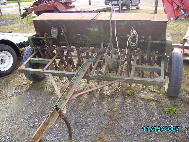

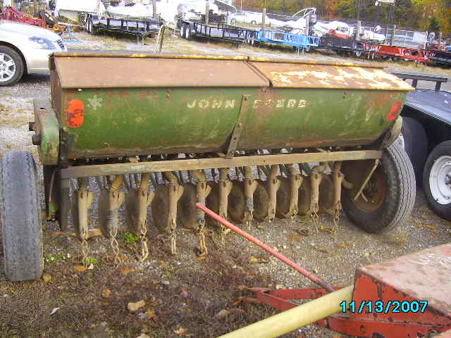

I found this drill on a used equipment lot today. It's old but I have been looking for something like this to plant food plots. Any of you guys (Farmwithjunk?) ever used one like this? What should I look for as possible trouble areas? If there are problems, are these machines fairly straight forward to work on? They want $650.00. What does that price sound like?

I think that's a model FB117B. (11 disc-7" spacing-FBB) , 6'-5" drilling width.
I've got an FB137B. (14" wider) They're about as basic and reliable as a drill can be. MOST parts are still available from Deere. I've got a small seed box that goes on the FB117B model you've pictured. (Rough, but usable condition) I've also got a spare manual should you buy that one. $650 is not cheap, but it's not out of line either. You'll stumble on to them cheaper at times, but generally not a lot cheaper. That model is a good one for a smaller tractor. 20 to 30 hp will handle it with ease. It'll plant wheat, barley, soybeans or any medium sized seed. Small seed (like alfalfa or many grass seeds) will require the small seed box.
Check seed box and fertilizer box for rust holes. Check for stripped or siezed shafts and gears. That is a power lift (as opposed to hydraulic lift) Check function of the lift. (Requires a tractor pulling forward on the tongue)
If you aren't familiar with a drill, an owners manual is a matter of necessity
They were built from middle 1950's until the early '70's. I believe that one is a late '50's model.

Models with press wheels are distinguished by model #'s including "PD" (presswheel drill) Very seldom will you see a presswheel drill in the midwest/southeast US. Most of what you'll find in this part of the country has the "cover chains" like the one pictured.
