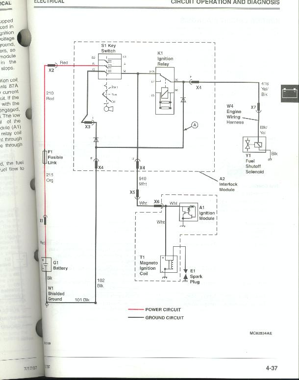

My JD 275 suddenly won't start. Put it in the garage two weeks ago, shut it off and today no spark.
It Will turn over. I jumpered the seat switch to be sure it is not that. And the interloc for the emergency brake is working because I can hear the solenoid for the mower click in and out.
I need a wiring diagram and some troubleshooting tips please.

I have the service manual and will take a look today. /forums/images/graemlins/grin.gif
Here are some copies of ignition troubleshooting.

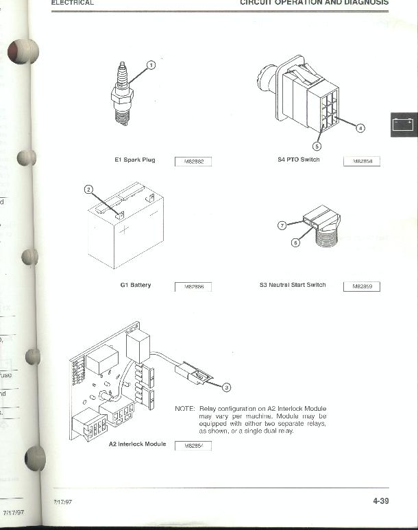

Another

   / JD GT275 won't spark. Anybody have a schematic? #6
Re: JD GT275 won\'t spark. Anybody have a schematic?
another one

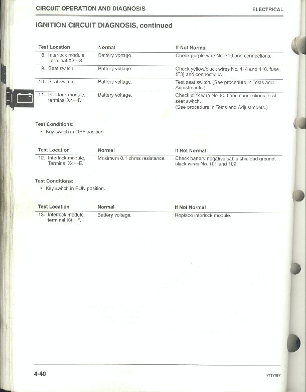

   / JD GT275 won't spark. Anybody have a schematic? #7
still another

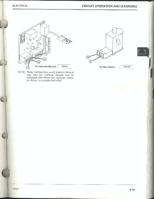

   / JD GT275 won't spark. Anybody have a schematic? #8
only this and another one

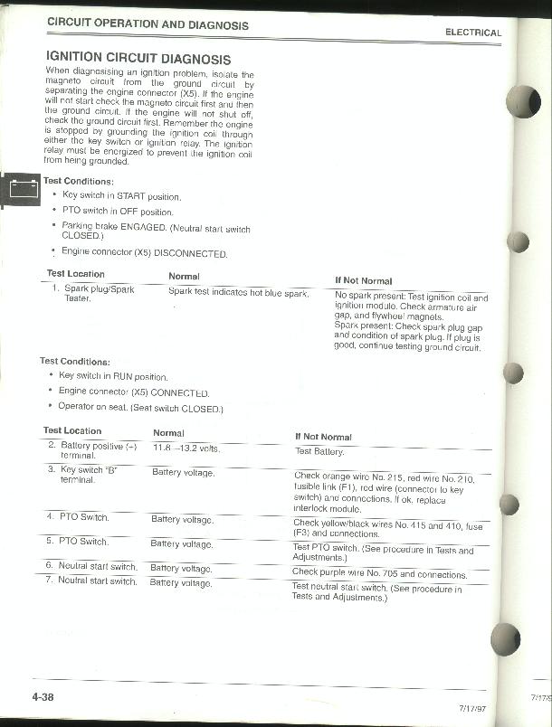

   / JD GT275 won't spark. Anybody have a schematic? #9
last one..Let me know if You need more.
