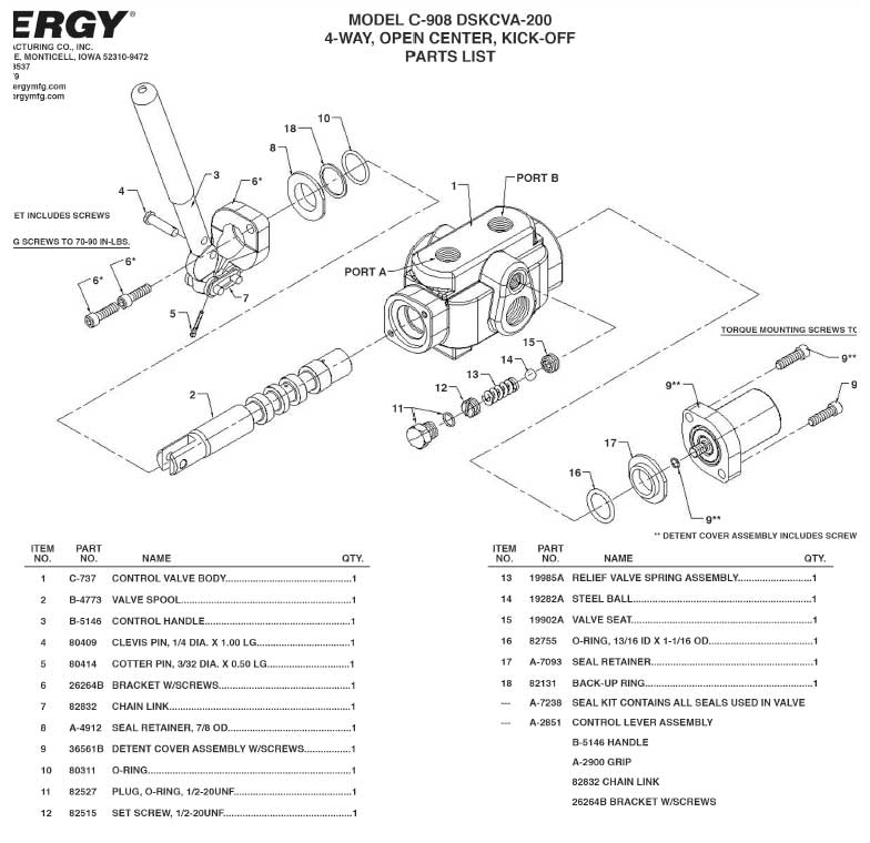

I'll have to check the valve for numbers, but the invoice says:
1 SPOOL 20 GPM PRINCE RD-2575 - T4 - ESA1 DA OC VALVE
The old ENERGY® Valve was open center. (See Attached)

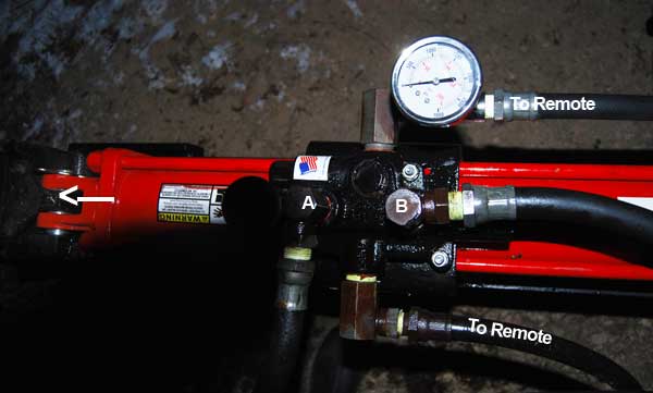

I'm a little lost on what you meant. Anyway here a photo of the new valve & cylinder setup.
   / JD Log Splitter SAGA Continues !!! #30
If your hoses are getting warm that quick in that temp you have a blockage somewhere. I would start by taking off all the QC on both the remote and the hoses and cleaning them and putting them together with nothing hooked to them and visually check them.
Also sometimes its a good idea to get someone else who is handy with these types of things take a look at it. We can only help so much here and I know I get tunnel vision sometimes. It could be your pump, tractors pressure relief valve, ect, ect, ect. You have spent a bunch of time on this and spent some money on parts that may not be necessary.
I would also try to hook up the gauge temporarily directly to each remote and check the pressure when you move the lever for the remote.
Chris
