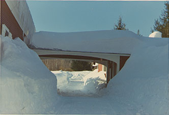

DPR -- Gotta differ with you on the chains. New England snow is generally pretty wet and heavy, so late in the season we get a lot of ice. Ice on a hill without chains, well, might as well throw a tarp over it and wait for spring!
I use the gnarly Norse ice chains with the inch long spikes on my L3010. Absolutely love em, and with practice am able to mount them quite easily even though they weight in at 115# each. The trick is to make the tractor do the work for you.
Pete
www.GatewayToVermont.com

Pete
I would not let you in my driveway with 1" spikes. They did not teach my tractor how to put on chaines. 230# is a lot to pull around plus, you gotta store them in the summer time. Also what makes the spikes stay pointing down, it would seem the chains would roll and the spikes lay down. The last time I talked about chaines they were ask over $400 for 24".
What do you use to remove the ice?
DPR
   / JD or Kubota?? #10
Tanuke01 -- The nearest paved road is half a mile downhill, and with the chains on I stay well away from the asphalt. The chains are arranged in a diamond pattern sort of like skidder chains, so the pointy parts always stay put. As for the weight, any additional weight in the winter is a good thing IMO. To mount the chains I lay them out in the driveway and have my wife back over them about 1/4 of the way. I pass a rope thru the rings on the front end and pass it over the tire, with me hanging onto the rope behind the tractor as my wife continues to back up. When the rings touch the ground I pass the leader from the other end of the chain through them and pull it tight before putting the shackles in place. Sounds very involved, but it takes about 10 minutes per tire. Until the snow flies, the chains help me with skidding logs (firewood) and do a good job of aerating the meadow. /w3tcompact/icons/shocked.gif I think I paid about $500 for the pair, but considering how much snow we get they were worth every penny.
Not sure what you mean about removing ice? You mean from the road and driveway? We call it spring thaw. Down in the valley they use salt, but none on the backroads like where we live. The ground is beginning to freeze now, and will thaw again in mid to late April. Till then we drive carefully, and downright defensively when we see an out of state plate.
