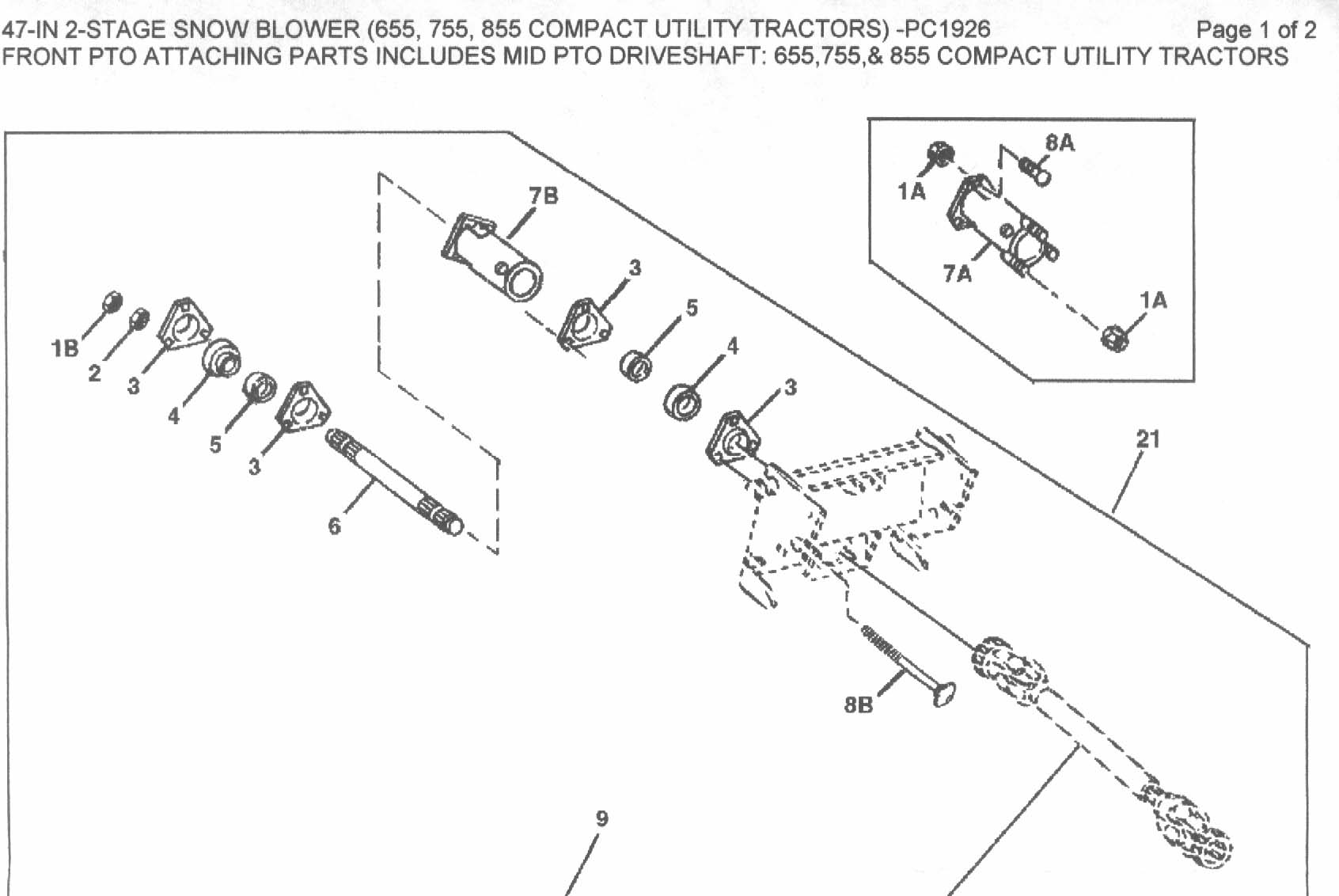

I don't know about a hump, the blower is very strong. Mine is only two years old still looks new. The is run off the mid PTO, there is a gear box added to the front of the tractor. A drive shaft goes from the mid-mount to the front gear box and one from the other side to the blower. The blower has a gear box. I think it is cast iron. No belts.

That's exactly what I wanted to hear! I was worried they might have used a roller chain as part of the speed reduction for the blower.
So there is drive shaft from the mid PTO to a gearbox on the front of the tractor? This gearbox then connects to the blower which has another gearbox for auger speed reduction? Just wanted make sure I understood that right...

Ill try it again.
You won't need glasses for this/w3tcompact/icons/smile.gifoops
