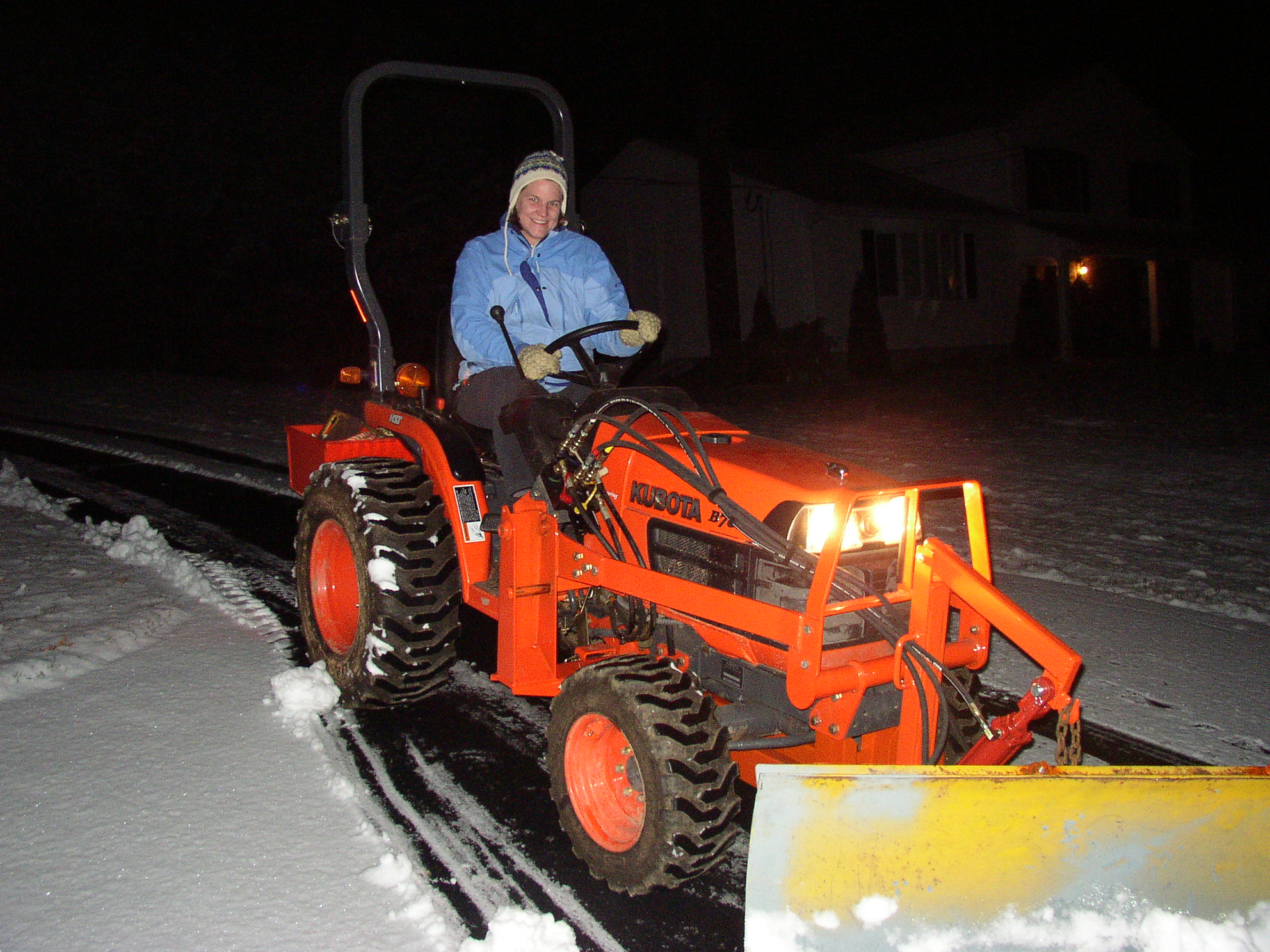

/ JD Pallet forks #9
Here is another really slick, and well executed solution. This install retains the advantages of having some float in a plow blade..... something else to consider...

/ JD Pallet forks #10
bxowner said:
kennyd -
So, if the 200cx and 300x loaders have the same pins, can I put the snow plow blade from JD on my 200cx?
I seem to remember JD offering a snow plow for the FEL on a 300x... I know they do for the 300cx. But there's no listing for a snow plow for 200cx.
Yes, it would fit...BUT
I built a blade for my loader a few years ago from a Meyers Poly-Plow, and while it did work, my tractor was just to light. I had trouble steering, and even going straight was a challenge. I just do not think the FEL plows are effective on the small frame CUT's. It also makes the whole unit so long that maneuverability becomes a problem in small spaces.
I have since found an older #380 frame mounted blade that I modified to fit and the difference is like night and day!
