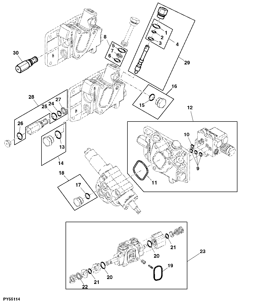

I have a JD 5045 and the book does not show how to set the PRV up higher-use this tractor to pull small log trailer with picker,thanks Albert

My problem is,i can`t find the PRV,they got it hit somewhere and i need to bump it up higher than the PRV on the log trailer...
/ JD pressure relieve valve #4
I was only able to locate 1 PRV(parts key #30) in the parts catalog and it appears to be non-adjustable.
