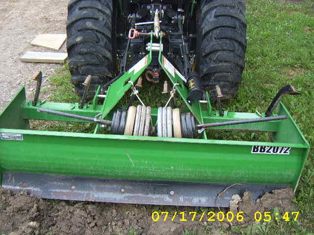

Hi radman,
This is a pic of the "new" R4's... larger, less space between the treads for the reasons aforementioned...
I think there is some tradeoff on traction to go with these vs. the other R4's... mine are like slicks when packed with mud or clay... of course everyone with the other R4's has the identical complaint, so...
BloomingtonMike has the other R4's on his, and a nice links to pics of his 3320 which show those treads very well.

Here is a picture of the treads on my R4s.
New Style

The Marathoner R4s seem to fill up with mud just like the Standard R4s but they also seem to eject it well from the treads. Also note that the Marathoner R4s are only 4-ply in the rear as opposed to the Standard R4s, which are 6-ply. Not as rugged of a tire but it may be more forgiving on a lawn and provide for a softer ride as stated. I have the Marathoner R4s and I'm glad I went with them.
Here are some pictures and their descriptions.
