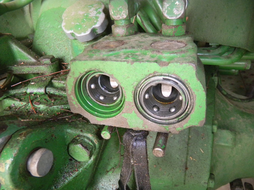

My 2030 has what John Deere calls breakaway couplers. They have the lever on the bottom that will push in the poppet/ball of the tip. You can just pull to remove the coupler, hence "breakaway" coupler.
In the picture one side (left) is forward. This holds the tip, the right side shows the female coupler slid back, tip is then released. The bore the female coupler is in is larger at the rear letting the perimeter balls release the tip. Forward the bore is smaller, forcing the balls to retain the tip.
