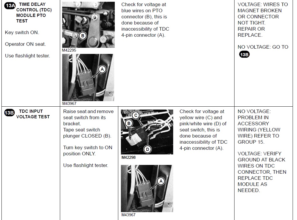

I only have a operators manual having trouble locating where the TDC is? PTO keeps working then goes off and doesn't work then its fine again. Wondering if the TDC is done as I did check on voltage at magnet and also I can pull up on switch and it works as soon as I sit on tractor it shuts off????

TDC meaning Time Delay Control module....
From service manual..

Thanks for reply in step 2 where is that location side of tractor can't seem to locate?
