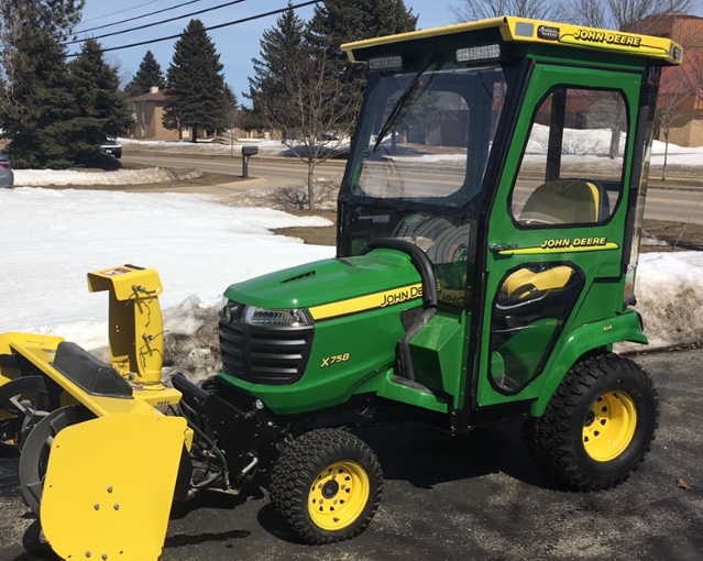

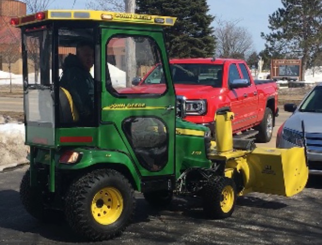

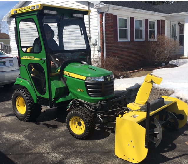

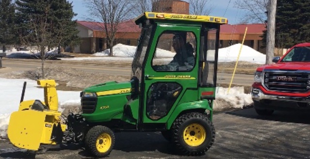

Today I pulled the tractor out of the shop for the first time with the new handbuilt cab. I put 1" insulation in the ceiling and front and rear of the cab. I also installed a overhead switch box for all the lights. Two 60 amp breakers and two 40 amp fuses. One breaker is very handy to push and disconnect when not in use. I even installed a overhead fan in case the windows fog up. It is not air tight but going to be 99.9% more enjoyable in the blowing wind and blowing snow. I love the little mini strobe lights. donecab1.jpgdonecab2.jpgdonecab3.jpgdonecab4.jpg

Curious about how the engine cooling air circulates?
Nice looking cab too.
