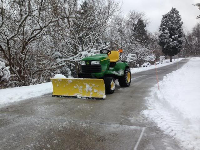

ok. I will change when I get 5-10 more hours and report back. My x475 i just have my own weight of 195lbs and using diff lock ive never gotten stuck. I run my AG tires aired down in the rear although they prolly need replacing here soon. not much tread left so they havent been doing as good in the mud. here is a picture for you all to see what you've been helping me with!

I can't tell, but it doesn't look like you have chains on the rear. If not, get some. Huge difference in traction. You won't need the diff lock much at all. Are those rears actually ag/R1's? Looking at the tracks in the snow on the side of the drive it appears that you have R1's. They will do a lot better with chains on pavement. I've used all three types of tire combos- R1, turf, and R4. They all do better with chains on pavement, especially with smaller machines.

No chains. tires are carlisle tru power AT 26x12x12. I never ran chains because with the diff lock I never had an issue but i didnt know it would be harmful if used alot. im not using it on dry concrete, just on the slick ice and hills. may have to go see what kind of deal they will make me on a 4wd x748 or x758 ultimate since this ol girl is 10 years old already(time flies!!). I will definitely look into weight for the rear now. Its gonna be hitting the 50's this week so snow may be done for this year. also are JD batteries that good? I have the original battery in this thing from 2004 and its still starts fine. multi-meter is showing over 13 volts??? I just thought that was weird because it isnt kept on a trickle charger or anything. im lucky to get 3-4 years out of all the batteries in our diesels.

Just because you get a 4wd won't mean that you shouldn't still use chains. I have a JD 4115 CUT, with loaded rear tires (165 lbs per tire 75% loaded with Rim Gard), and I still need 4wd most of the time. I will be getting chains for next winter for sure. Ice under snow or packed snow will make any tire slip.
