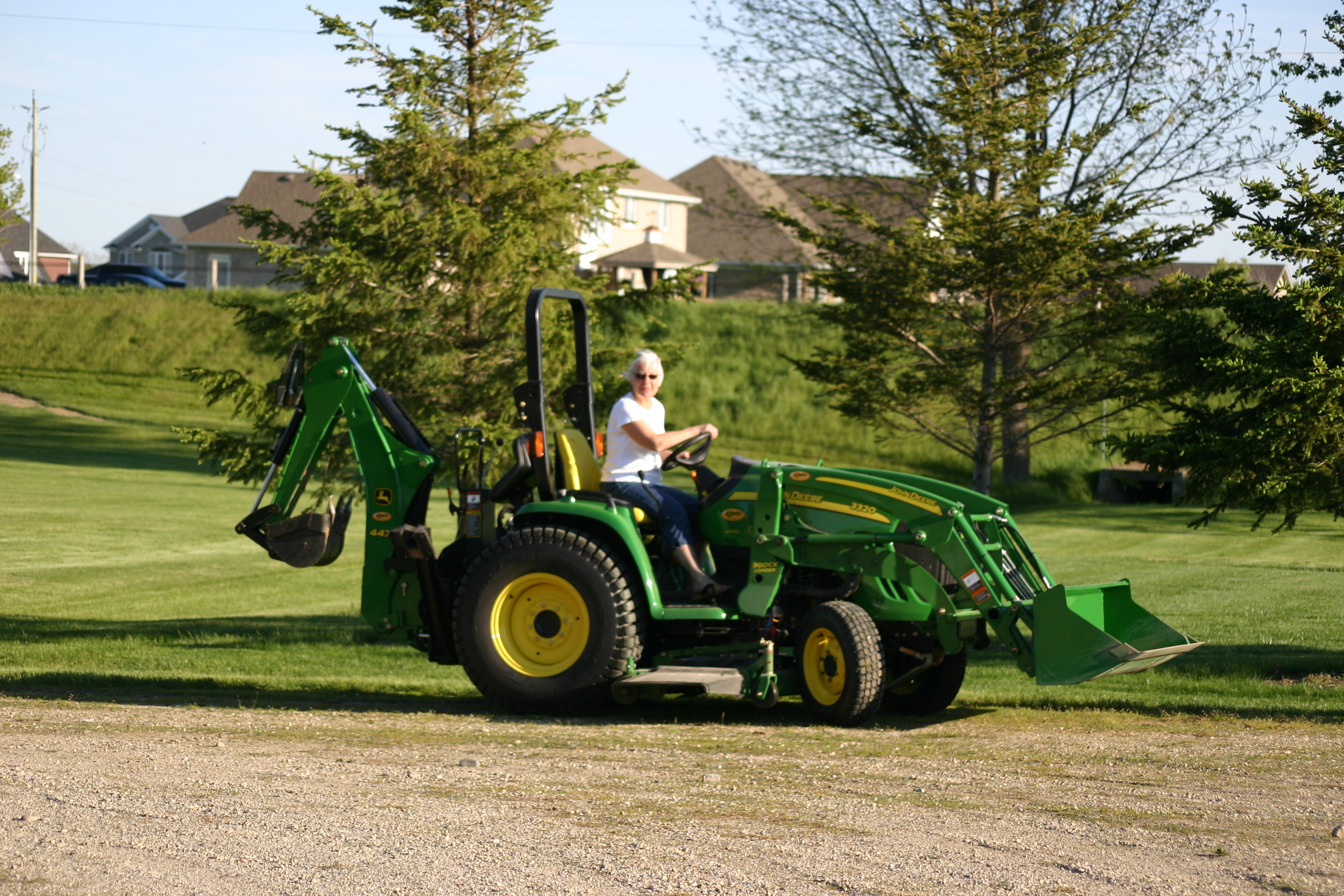

Take a look at the slope behind the tractor. I have not measured it accurately, but it is fairly steep, I think quite a bit more so than your slope.
1. Sears Craftsman / 25hp / RWD / Diff Lock / Turf Tires. Could ride along the top of the slope sideways - one pass - for most of the length and sideways on parts of the left end where it is not as steep. Could drive straight up / Back down in most areas, but if slightest dampness would spin out on the right steep portions.
2. JD 3320 O/S or JD 3320 CAB with Turf tires and MMM. Sideways on parts of the left of the slope. Drive Up and Back down anywhere on the slope in 4WD with no problems.
3. JD X739 AWS / AWD / HDAP tires. Can drive sideways anywhere on about the left half of the slope with no slip / slide. Drive one pass along the top for entire length. Drive straight Up the slope turn 180 at the top and drive straight back down. No slip / slide.
I can't speak to the X500 series, but have no doubt the X739 would handle your job without breaking a sweat.

Wow, that slope is much more aggressive than what I'm dealing with. Thanks for your input
   / JD X584 4 wheel turn for 20 degree incline #20
Wow Cinder- that is a heck of a slope- the Craftsman is not in same class as a x500 series,although it has Diff lock, it is really a lawn tractor, not a garden tractor. The JD has much more torque , bigger tires, wider stance. But having said that, not sure how it would handle your slope, I would be nervous on certain parts of that slope even with a X739
