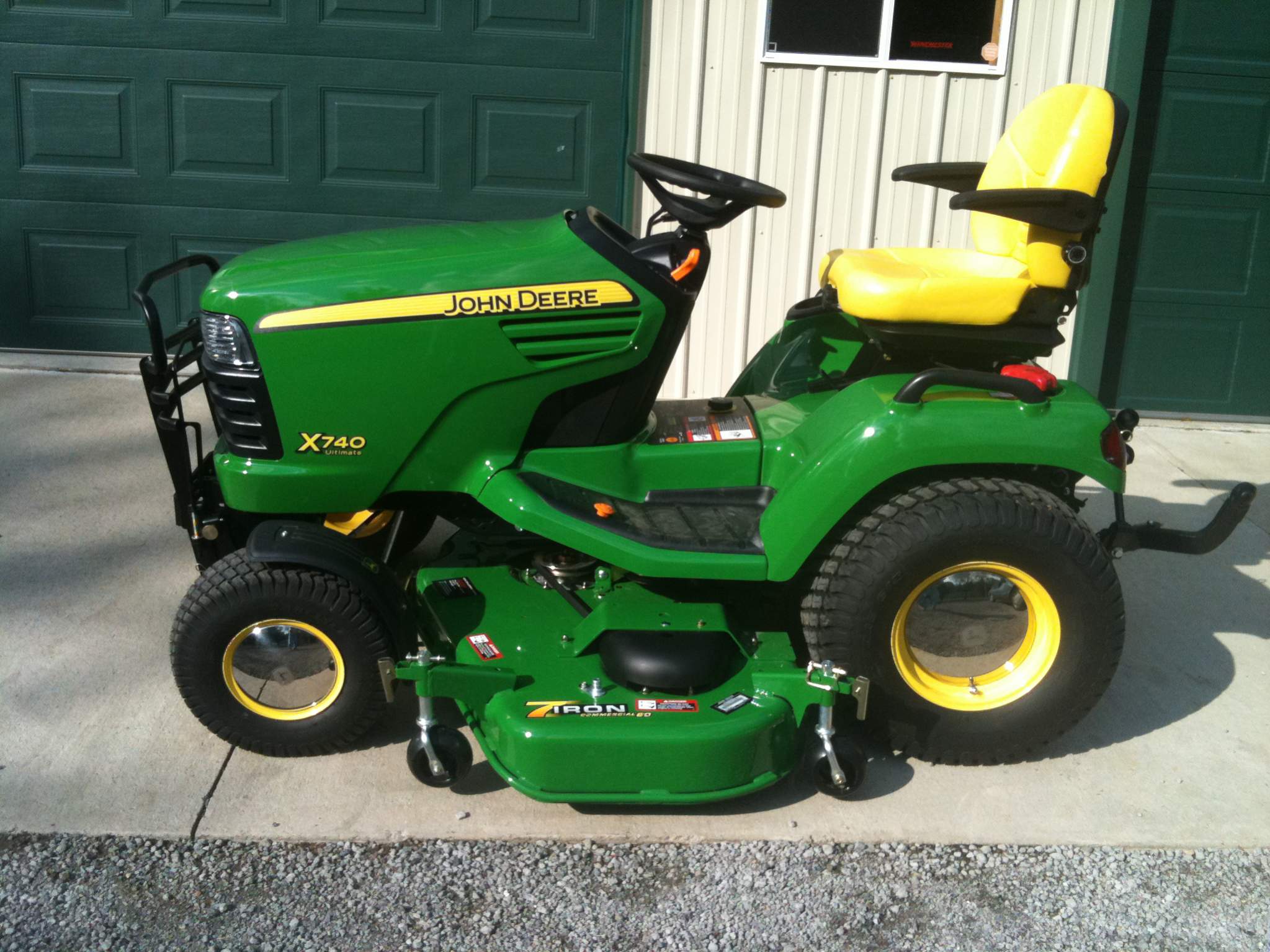

Another reason I upgraded to the 7 iron deck back in 2011.
