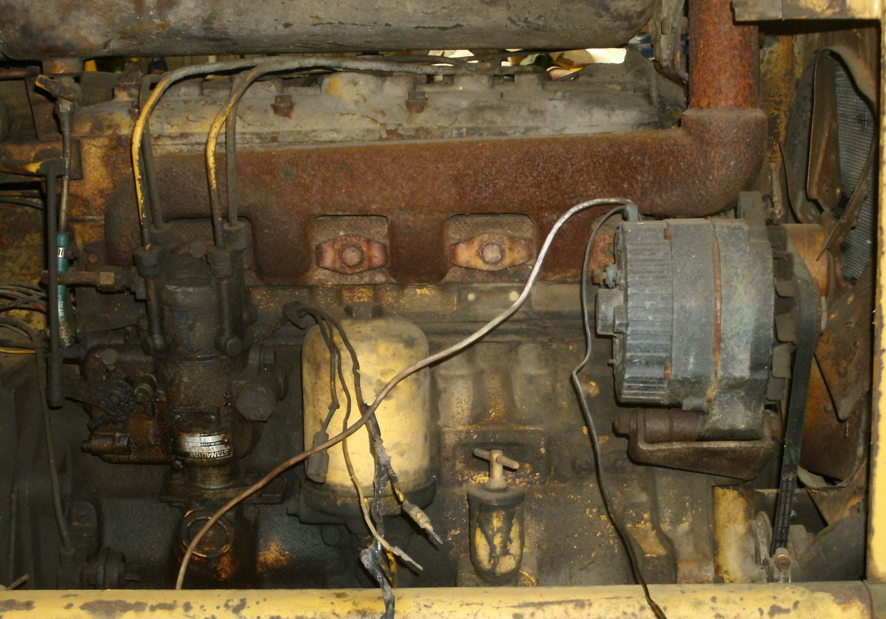

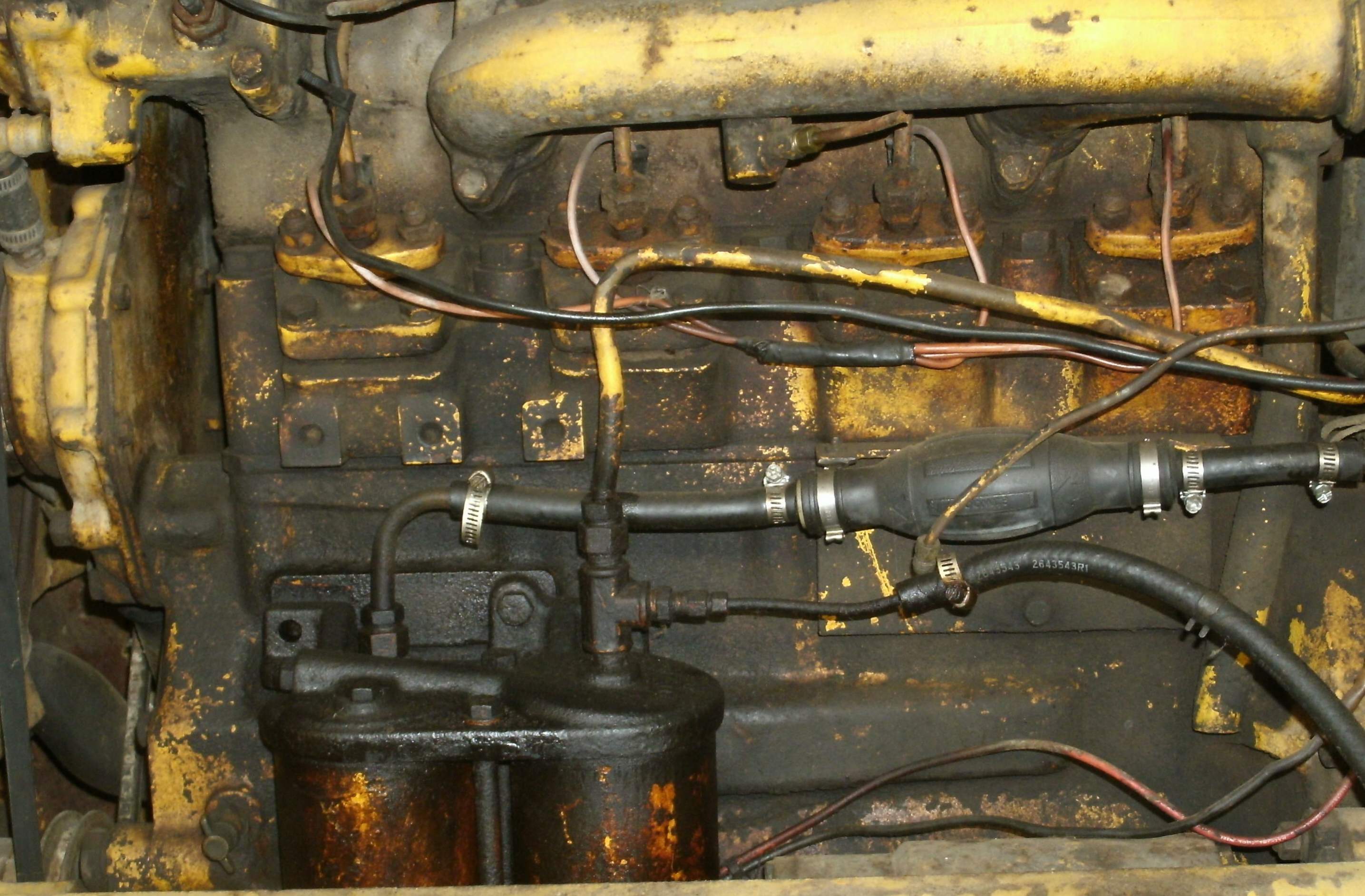

I have a JD1010C diesel and it is a basket case. The machine was converted from a generator to an alternator and all of the wires are hanging. The fuel system is also in disarray with many of the fuel lines broken and hanging. Does anyone have a picture the fuel system un-modified? I have been looking for a wiring schematic as well. HELP

Does the alternator have a built in regulator or separate regulator?
   / JD1010C basket case
I "assume" that the regulator is built in
Just two terminals
   / JD1010C basket case #8
With two terminals, large is output and goes to starter solenoid (same terminal as battery connects to). Small terminal needs 12v to start the alternator charging. Normally comes from key switch, a wire that is hot when the key is ON. It should have the alternator light in the circuit. 12v from key switch to alternator light, then to alternator. This light will NOT have a ground. Light will be ON when key is ON, and go OFF when the alternator starts charging. Think of it as battery voltage coming from the key to the light, and once the alternator starts to charge alternator voltage going back towards the light. The voltages cancel and light will go out.
You might want to have the alternator tested.

Do your injection lines look something like this...
   / JD1010C basket case #10
skyhook
I don't what PC your schematic came from but it definitely wasn't from a 1010 PC because 1010 inj pump mounts vertical not horizontal.
