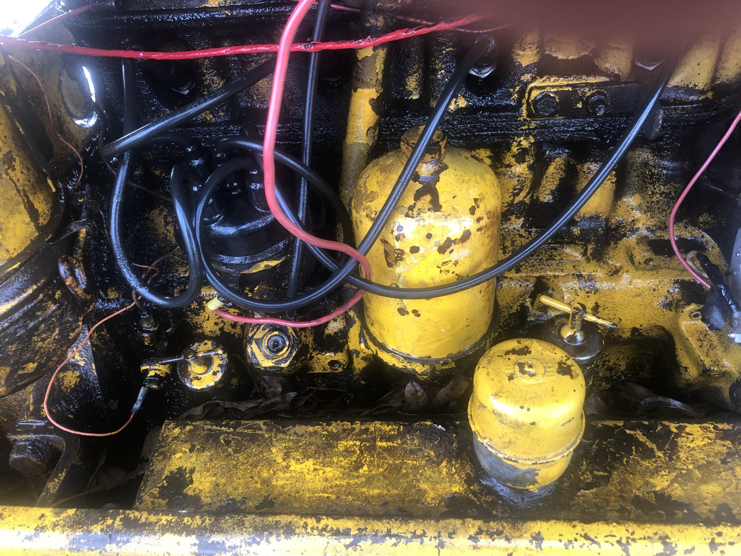

JD1010 Crawler been under a tarp in the woods for over 35 years.
Got it out and running. Hydraulic fluid and engine oil changed.
Question: on the right side is the engine oil fill and toward the front past the oil filter is another “check point”..what is that? Transmission fluid?
Went through owners manual and can’t determine what it is.

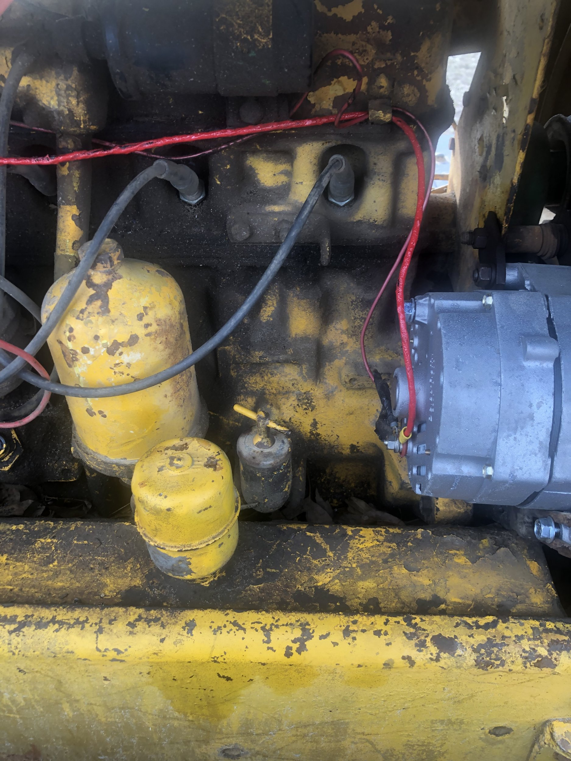

/ JD1010C Fluid Checks
Picture of “fill points”, to left of oil filter and not sure what the one to the right is. Just a plug, no dipstick.

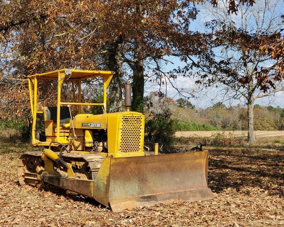

Wow! That looks like a real nice find! What's the history on that old JD?
Crawler was my son’s father-in-law, and as long as I’ve known it has been in the woods under a tarp.

/ JD1010C Fluid Checks #8
Looks like just another fill point, maybe due to when a loader is added to this crawler and no way to get at the one to the left to fill with oil. But certainly looks like it just goes to the crankcase. Shows in jdparts as a plug, best I can tell.
Key item #34, plug cupped
