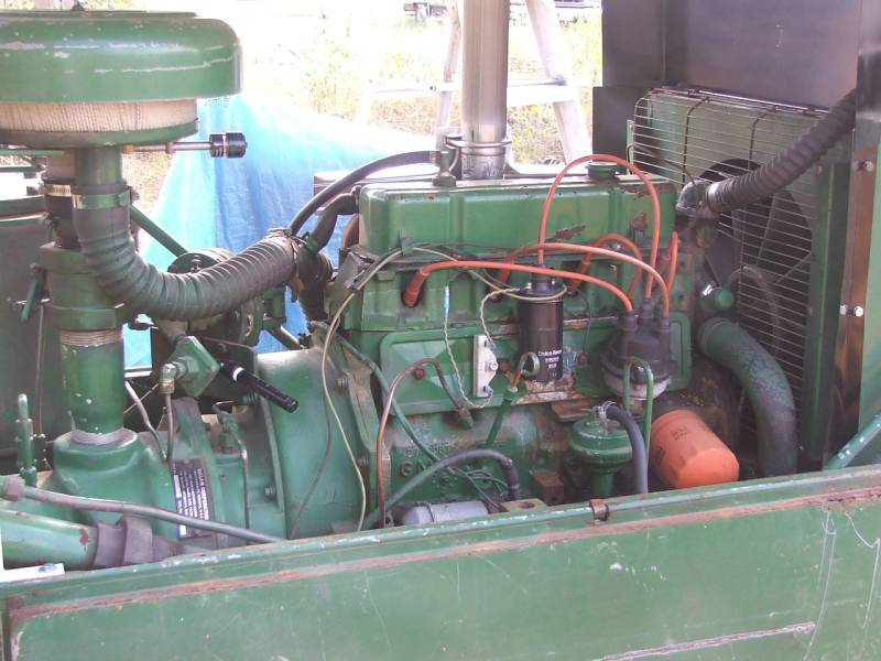

Found a picture of the coil. This is my old Sulair 160 compressor. It's not a JD but it shows a typical coil/resistor set up. The coil is black and mounted between #2 #3 cylinder. The white item to the left of the coil is a resistor. Find YOURS.
