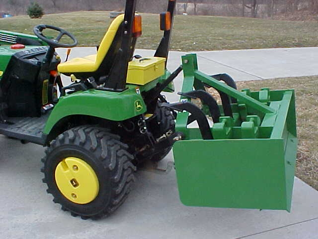

   / JD2305 Ballast box vs 48" box blade for ballast? #9
I agree, the boxblade is good for light weight, but I have purchased a number of clip on weights and find adjusting the needed ballast very easy. In the picture below, I have 4-suitcase weights, but I routinely add 400 lbs when needed for heavy work. Personally, I like this option for rear ballast because of the following reasons: it's now a multi use implement, covers my tracks which consequently cover the complete rear when back up in tight places, especially the woods so it keeps the entire rear protected and I can add/subtract weight as needed.
