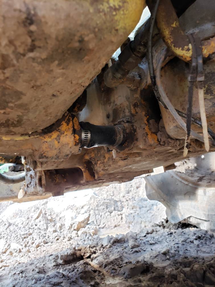

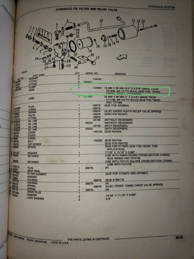

Where could I find this hose, or what could i use? I can not seem to find low pressure hydraulic lines and I do not want to leave my system drained for days.

McMaster Carr has 3/4" id low pressure hyd. hose..

Try NAPA or your local JD dealer.
   / JD300B hose from Hydraulic filter to Transmission Help?
I went to NAPA the guy was unsure about if the hose would handle hydraulic fluid.. The dealer I originally went to said they don't have hoses, So I am calling around again today. If no luck I will order from the site above.
My main concern is that I am unsure if leaving the system without fluid for days would cause harm or not?

Yeah. I did end up finding a place nearby that does make them so I am going there to get one! Thank you for that site also!!
