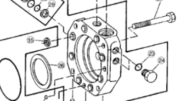

JD300B hose from Hydraulic filter to Transmission Help?
   / JD300B hose from Hydraulic filter to Transmission Help? #11
Get a 5000# gauge with a short hose. Connect hose to orifice where plug(key 24) is located on RH side of hyd pump. Connector size required is 0.375 IN/24 TPI/ORB
#12
Okay I will buy and test it out.
Right now what was wrong was the hydraulic fluid was really milky and had a hole in a line squirting fluid. I changed the hose. Now changed out the milky fluid, transmission filter & hydraulic filter.
When I move either of the Backhoe levers somewhere below has a loud continues vibration Thud like sound.
   / JD300B hose from Hydraulic filter to Transmission Help? #13
Did you check/clean hyd oil sump screen?
#14
I got it pulled out just a little and it looked clean. I could not get the whole thing out because it was stuck and would only spin but would not pull out.
   / JD300B hose from Hydraulic filter to Transmission Help? #15
Screen should pull out of trans case if not clogged or crumpled.
#16
Yea it only came out maybe half an inch? Then was stuck in there and I didn't want to rip it out and break a piece off inside so I just slid it back in and put the fluid in. The fluid was so milky and the filters was so tore up I figured that alone may do the trick.
