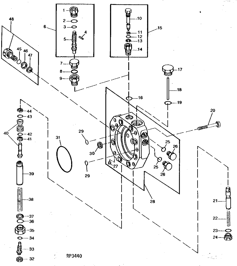

Hello everyone. I am new member who could use some advice. I have a 1972 JD 300b backhoe diesel that has a starting issue. When it sits for a day or so it starts right up after running it if I shut it down it barely turns over and will not turn fast enough to start. Battery voltage checks out. It seems like hydraulic system is putting a drag on the engine. All selective valves are in neutral position. Has anyone ever had symptoms similar to this on their machine? Any help would be greatly appreciated. Thanks

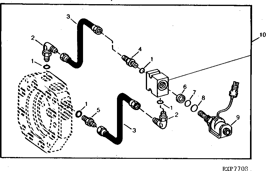

Has battery ground cable been relocated from battery box connection to engine block/starter mounting bolt?? If your TLB doesn't have a hyd destroking screw(parts key 6) you can install and use it to put hyd pump out of stroke while cranking engine.JD also offers an electric destroker kit. These parts listed fit the larger pump & if your TLB has the smaller pump it requires different parts.
parts key 6-AR96625 Pump Repair Kit - FIELD INSTALLATION KIT, SCREW, HYD ADD 16.88 USD
RE40463 Hydraulic Pump - HYDRAULIC PUMP, HYDRAULIC PUMP ELEC ADD 617.77 USD
